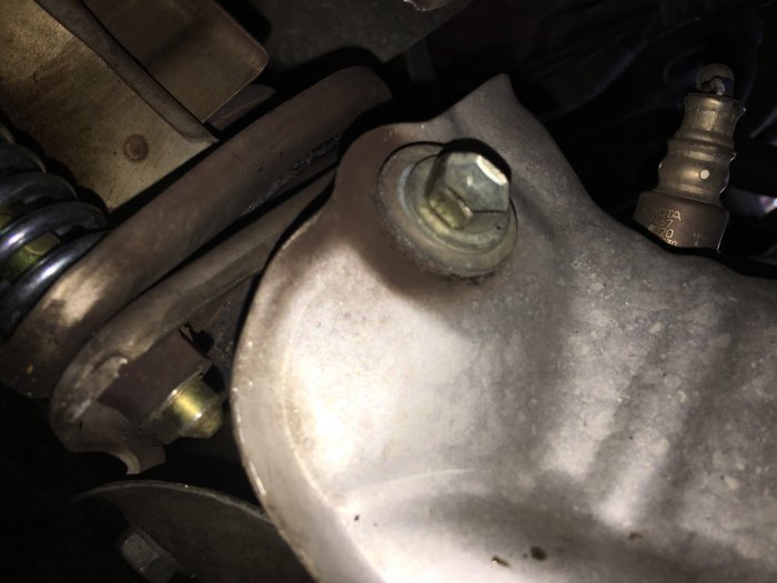

From this pic seems there’s a gap where the manifold downpipe and exhaust system join.

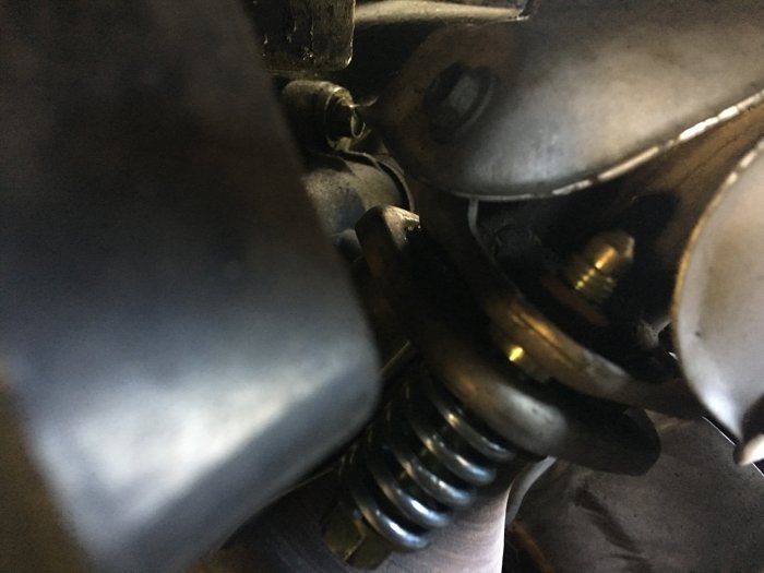

i did replace the donut gasket but i still get the sound sometimes, i have notice that springs may be in a compressed position sometimes when i park it (driveway is uphill). Maybe the springs aren't strong enough? Its not a rattle sound, more of a "no exhaust" noise and it sounds like there is a separation right where the flange and muffler section meet.
I replaced the spring bolt kit. i took pictures (the second pic was too large) this morning and it seems like the springs give way pretty easy. I have attached a pic where the spring kit install and its current position. The driveway has an incline and i'm thinking that maybe the system separates a bit when i enter the driveway.
