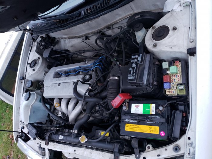

I have a 99 Corolla CE (Auto Trans). I went one day to start it like normal. It cranks and wants to start but, just won't catch.
Note: No sound from the Fuel Pump with key at start should I hear a something?

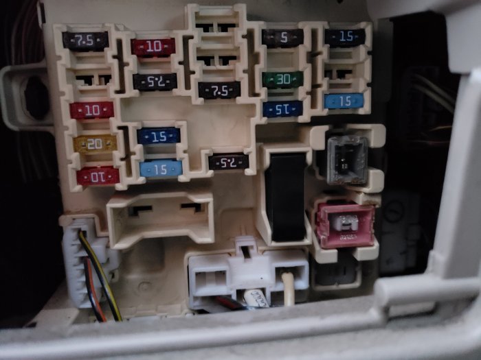

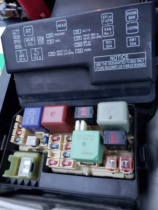

  • Relay: I swapped the (EFI or F-HTR) and the (HORN). Nothing changed
  • Fuse: I checked the blue 15a (EFI or F-HTR). Looks good

The fix turned out to be. Removing the air filter and spring in starter fluid. For the win! :)
