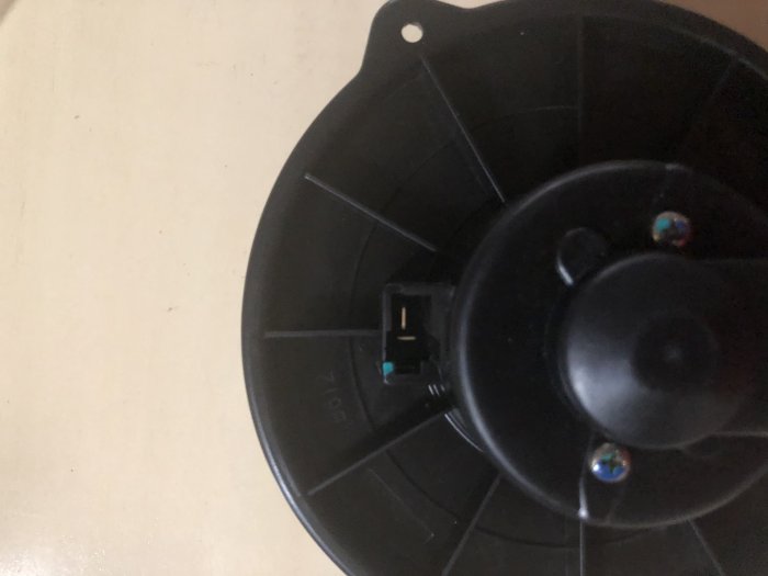

2008 Corolla blower
I have an 08 Corolla too.. stupid dealership...
The was a major change 2008 for Toyota Corolla.. 2008 was their introduction of the 10th Gen Corolla. So, they are selling parts for the 10th Gen Corolla.
You need to quote them an 2002-2005 or 2007 Corolla for parts related.

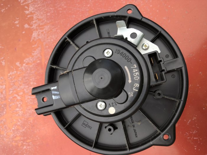

Late to the party, sorry. I have a 9th generation corolla (2005) and my blower was making noise. It looks just like yours. I bought a used OEM one on ebay from a highly rated seller. "03-08 Toyota Corolla OEM A/C ac heating blower motor fan factory # 194000-1510" for $50.00. It works very well.
ok guys i have found the part and posted a fix for this the part you need to look for is 40 dollars on amazon but its not for a corolla it is for a lexus es300!!!!! i dont know why they put lexus parts in my car from the factory but im glad i found it part number is tyc 700029 on amazon
