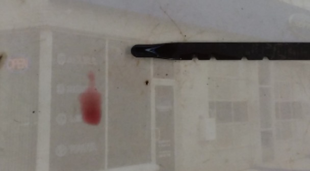

Some fluid from the dip stick:
https://db.tt/GQuynrmM

Transmission fluids are colored with a pinkish/reddish dye and as the fluid reaches the end of its useful life, the color will change to first a tan, then brown and then black. This provides a visual indication of the condition of the transmission fluid. Another check to perform on transmission fluid is to smell it and see if it smells burned. I am very glad you shared the pictures that you did because we can see this fluid is indeed very old and I recommend changing it before your Corolla needs a very expensive transmission rebuild. Expensive as in around $2,000 - $2,500. Call a Toyota dealers Service Department and ask them in general what a rebuilt transmission job would cost for your Corolla. Prepare to pick your jaw up off the floor. I don't feel it's wise to risk that kind of a big financial hit by not changing the transmission fluid. By the looks of that transmission fluid, I recommend changing it. Of course, if you're independent wealthy and have a ton of money falling out of your wallet, well then I guess it's not so urgent? :D :icon_lol:
