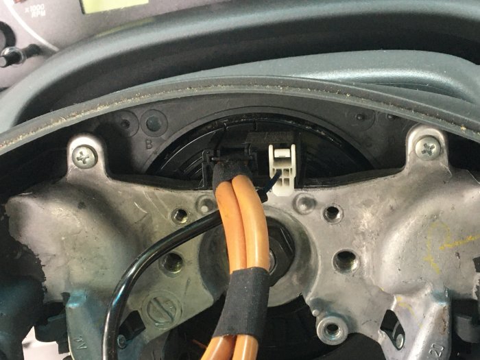

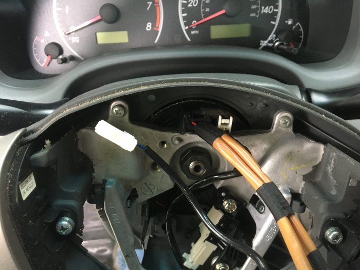

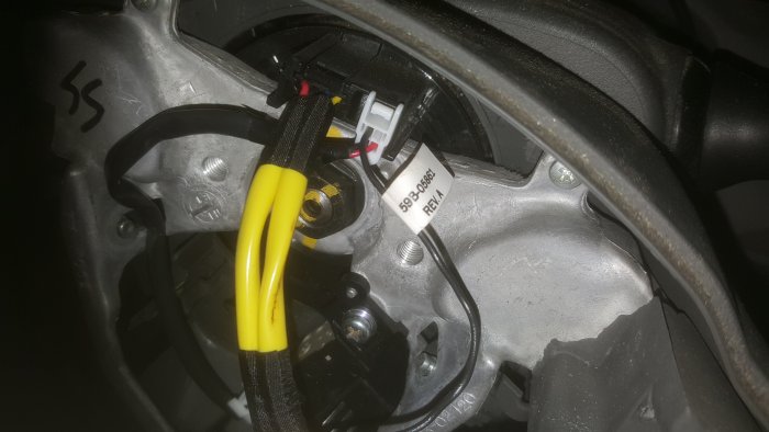

I do have a picture. Going to try it again in the AM. But the cruise did not light up when it was plugged in. Does the horn ground have to be grounded for the cruise to work? First picture is like it was when I took the airbag out, the second was with the cruise plugged in. IMG_0751[1].JPG IMG_0754[1].JPG

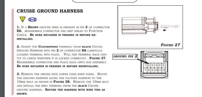

I looked over the instructions again (Including Toyota ones, about the same, http://toyotaparts.sparkstoyota.com/install/00016-01208inst.pdf) and they all say to ensure ground is plugged back in. Just wondering, did you verify the ECM has a wire in the proper spot?

The cruise control wire has 2 wires in the bottom 2 slots of the 4 pin plug. the upper left was where the horn ground was in. The horn ground was also a 4 pin plug, with only the upper left being used. (Cruise only has wires on bottom 2).
That sounds like what I remember mine had. When I looked at instructions again both Rostra (figure 17) and Toyota (figure 9) show 3 wires being used at the plug. I'm pretty sure I cut the 'plug' off the ground, extended the wire and put a grounding lug on it. Don't remember where I attached it but guessing one of the phillips screws that show in your pic. I.m thinking without the wire connected there is no ground going to the switch.
Or if you have the right tool you could try popping the ground wire out of its connector and putting it in the proper spot of the cruise connector. I don't have a tool for that and didn't want to chance wrecking a connector.

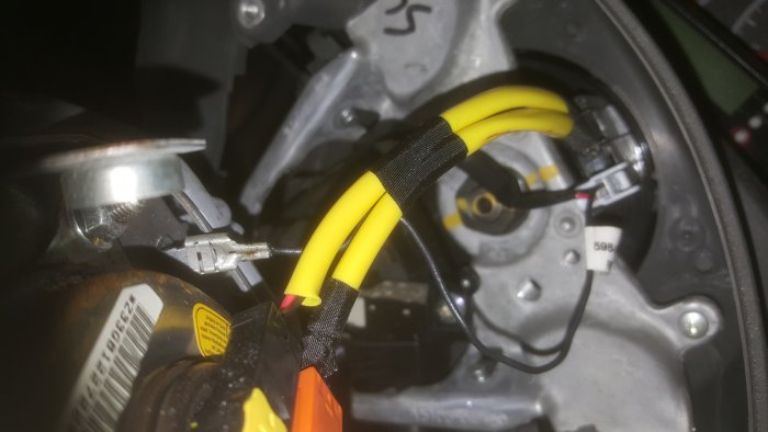

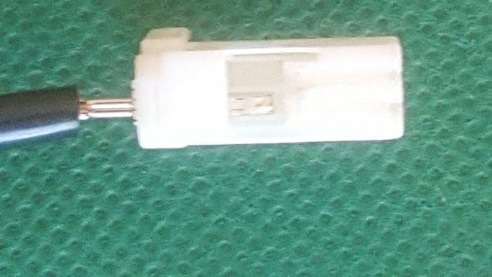

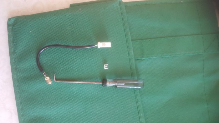

Took mine apart. I had gotten a wiring kit thinking my car did not have the wire running to the ECM from what I had read about the VIN . Mine did have it but in that kit was a wire with an end that fit into the cruise plug and the other end clipped on to the back of the air bag.
Thanks, that is exactly how mine looks. Going to try the CC switch again. Guessing maybe a bad switch? Bought mine on E-Bay. I need to find an adapter like the one you have for the horn ground. I cut the wire off the horn ground a bit too short to re attach (DOH!), thinking it would ground off one of the phillips head screws, but no luck on the horn. I am sure I can get the horn grounded, but that adapter would be the way to go.
Thanks for the pictures, appreciate the help.
I found the bag it came in. Got it from Toyota years ago. 00016-01208-02 but it doesn't show as available any more. It looks a lot like the wiring kit that comes with the Rostra set up. Maybe they would sell it by itself.

The cable is just a wire with the proper end on it to slide into the cruise plug that attaches to the steering wheel. The other end then connects where your original (horn) wire did.
1) If you find a steering wheel I think all you would need to change out is the cruise harness, not the entire wheel.
2) I found my old wire and discovered it can be taken apart with a small hook tool. On the side opposite the clip, there is a small center piece that can be removed. it's a little tough to see the edge lines but once found pry on it gently to remove it. This now gives you access to the wire end. I used the tool to gently pry it out of the connector. This would now slide in to the proper spot on the cruise connector.
Hopefully you have enough wire left on the pin to extend it.

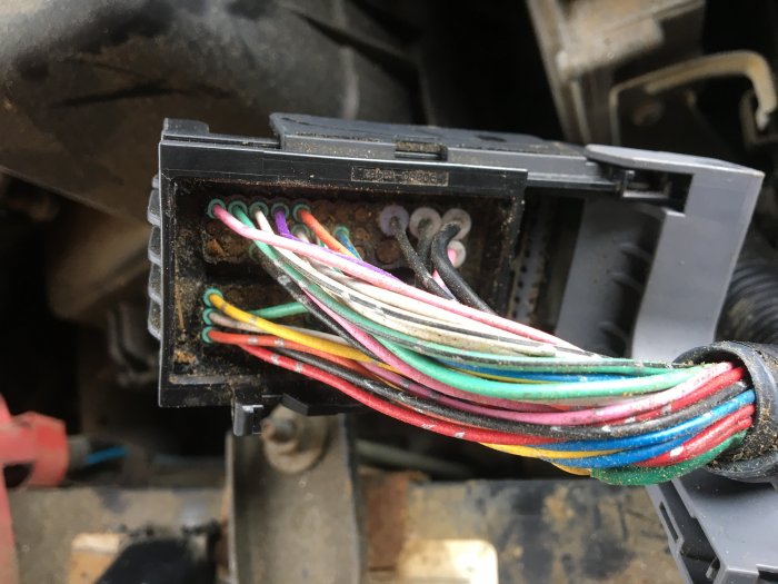

LMFAO. So, 3 Corollas on the car lot. All a bit over 100K miles, 2009 to 2011. Which one do I pick? Probably the only one NOT (as far as I can tell) wired for cruise control. Cue Homer Simpson... DOH! If I am reading the instructions right, pin 40 is on the bottom left of my picture, below the yellow wire. IMG_0764[1].JPG IMG_0764[1].JPG

Well, got the wire run into the ECM plug. (Don't push the rubber plug in, trust me...) Need to get something that will cut the plug to run the wire into the cabin. So off to Oreilly's in the AM. Hopefully will have cruise Sunday. :)
