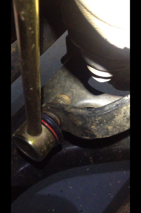

soo...what was it? going to leave us hanging? my car started this occasionally over the last few weeks. coming from the front right as i turn right or left occasionally...2010 corolla s with about 111000 miles
Sorry, thought I had posted a video. My bottom front sway bar down linkage (I think that is the correct terminology) was a little loose. Tightend it image.png and viola.
