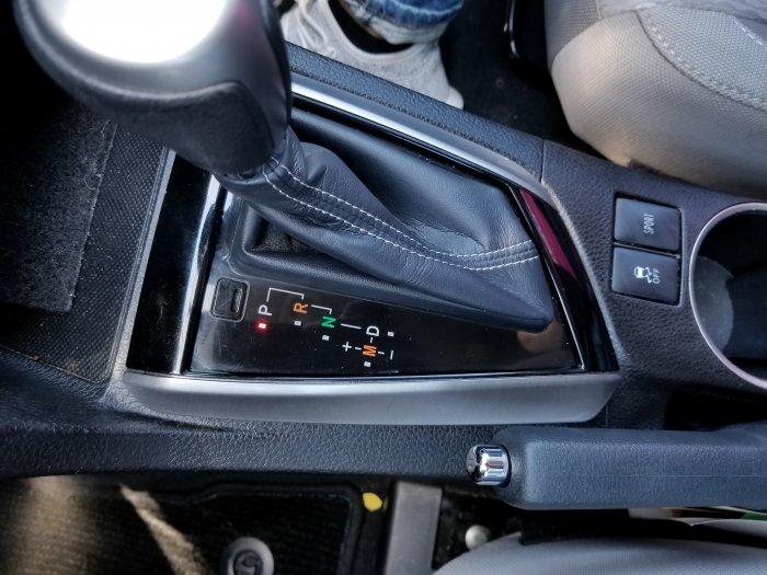

So I have a 2014 Corolla that I've turned into a "S"

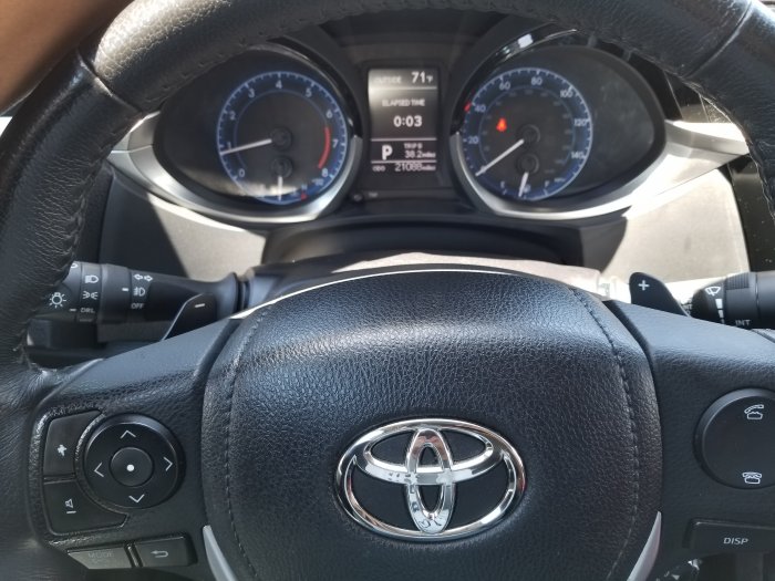

But the paddle shifters don't work nor the "S" shifter that I replaced with (M-/M+) . Does anyone know how I can get it to work ?
The ECM should support manual shifting for it to work. The + and - switch of the floor shifter and sw switch are just parallel connections going to the ECM.
