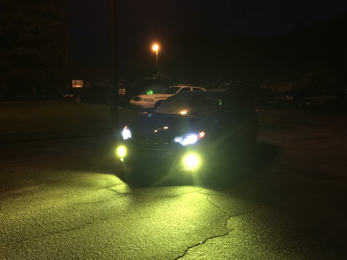

So I just picked up a used 2014 Corolla S in slate metallic with only 15K miles on it. Been doing quite a number of upgrades to it already on the weekends. I live in Orlando, FL which is quite hot most of the year so I have focused on upgrades to stay cool. I built a custom sunshade using Reflectix and cardboard for the rear window that doesn't need to be removed while drivng (huge decrease in heat in the car, when used with a front sunshade), I replaced all lights with LEDs and did a LED glow under the foot wells.

Loving the look man! I just replaced my map and some lights with some led's waiting to get some strips for under the dash. Was the license plate lights difficult to do?
No very easy actually, you can search for a video on youtube, took me less than 5 minutes to change them out. They sell full LED conversion kits on ebay for around 8 bucks, well worth the cost.
