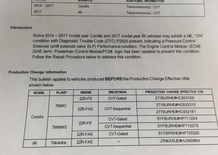

Help me understand this, so if my VIN is 5YFBURHEXFP2_ _ _ _ _ does that mean my car is affected? In your document from MISS plant TMMMS 2ZR-FE CVT-Gated after # I see HP7. Mine's FP so I wonder if FP models aren't affected. Please provide input if you're knowledgeable in this VIN number jazz. Thx. :)
The letters are some production code. Only the last 6 digits are relevant. It also mention "some", not "all" previous car might be affected.
Furthermore, assuming this is a TSB (we have only partial view of the document), it is not necessarily related to wide spread problems and even less to recall/service campaign.
More like instructions to the mechanic ("If you encounter a car with this condition, this might be the solution). I've even seen TSB from Toyota about tire rotation and oil change... ;)
