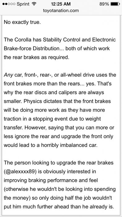

I was discussing this in toyotanation. Here is the best response I can share.

They are correct when talking about balance, but that really applies when you regularly take the car to 10/10 to 11/10ths of its limit. The reality is that the severe forward weight bias does not put much stress on the rear, especially with the weight transfer that takes place under hard braking. The biggest benefit could be less fade from the rear with discs due to better heat dissipation. I do not know about the Corolla, but doing a disc brake conversion could be prohibitively expensive as well. The Corolla is also more or less designed to be reliable, economical, and efficient transportation and not a canyon carver. It all boils down to your passion and the size of your wallet with what can be accomplished.
