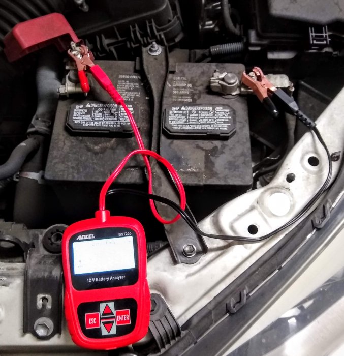

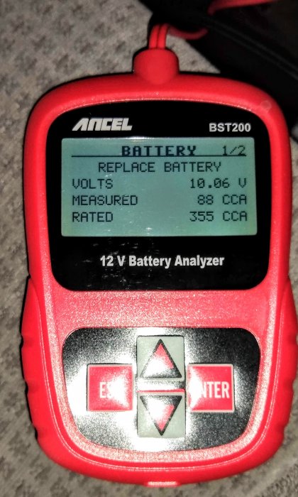

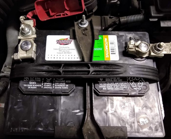

will keep posted, i ordered a battery tester and a wrench in preparation for changing a battery. if battery tests comes as replacing battery, i will make a trip to costco to get a battery
