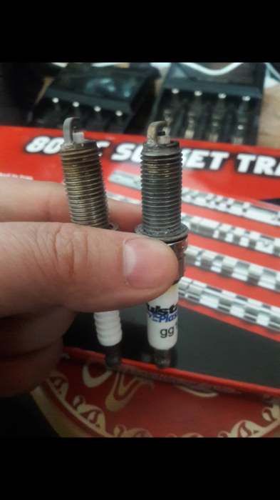

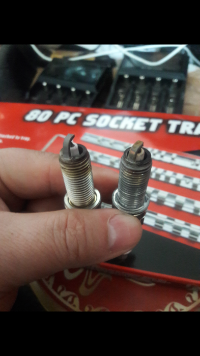

The Pulstar gg1h has a larger ceramic core than the oem SC16HR11.
The new FXU16HR11 has a hex nut size of 16mm (5/8) and not 14mm like the oem SC16HR11. Also the FXU16HR11 has a larger ceramic core like the Pulstar, which will make your COP boot stretch a little bit and over time degrade/ stuck rubber boot! Plus no runs on ceramic core to prevent sticking on boot.
If you plan to do this upgrade use Denso FXE16HE11. Because FXE16HE11 has same 14mm hex nut size and same size ceramic core as oem SC16HR11!

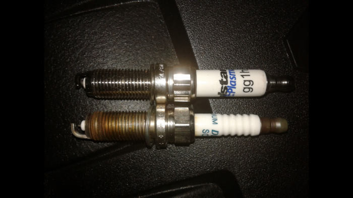

Screenshot_20170119-104510.png left oem. Right Pulstar.

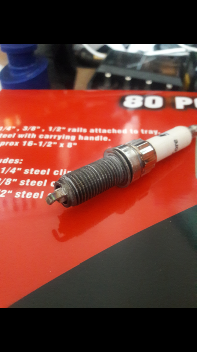

Pulstar alone.
Sorry i didn't take pics of all three plugs. I was in a hurry before temperature outside reached freezing.
