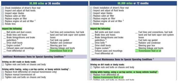

130,000 miles. I don't see anything in the manual regarding a transmission fluid change.
It's in the warranty and maintenance guide.
(You don't mention if it's a CVT or a manual). If CVT, see procedure below.
