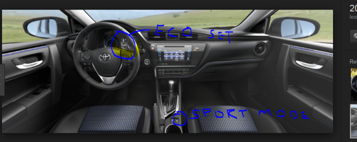

I set up the eco mode on on the + where your eco button is I have a sport mode

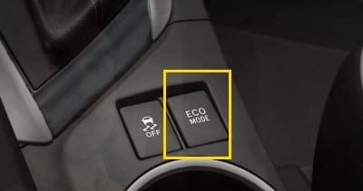

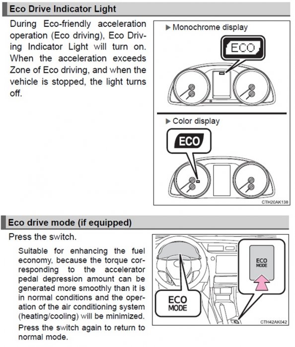

Then it’s as I said: what you’re showing activate the Eco drive indicator. It’s in every Corolla and just indicates that the driver actions are compatible with better mpg. It changes nothing to the car performance, behavior or operation.
Not to be confused with Eco drive mode which dulls everything from acceleration to AC and is only available as an option on LE Eco (just as the sport mode is found in S, same button placement). Extracts from the owner manual below.
That being said, your question about mpg remains unsolved ! :rolleyes:
