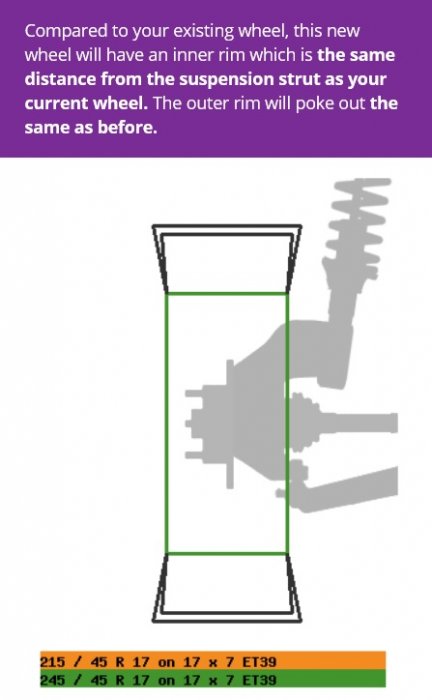

245/45r17 on my 2014 Corolla what do you think ?

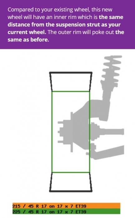

am I crazy every on was like they won't fit they will rub .nope at full lock they rubbed the lip of the fender .i I rolled the lip a bit with the aluminium baseball bat and a heat gun took about 20 minutes my rims are j7 17 inch with 24 offset now clearance to the fender I cut the plastic lining on the inside of the fender a bit to for more lock .the car looks mean now wider is better look .21545r17 are too small looking 225/45/r17 235/45r17 look good but you have will to roll the fenders anyway to fit anything bigger than 235/45r17 .so it is possible to fit 245/45r17 on a 2014 Toyota Corolla .
