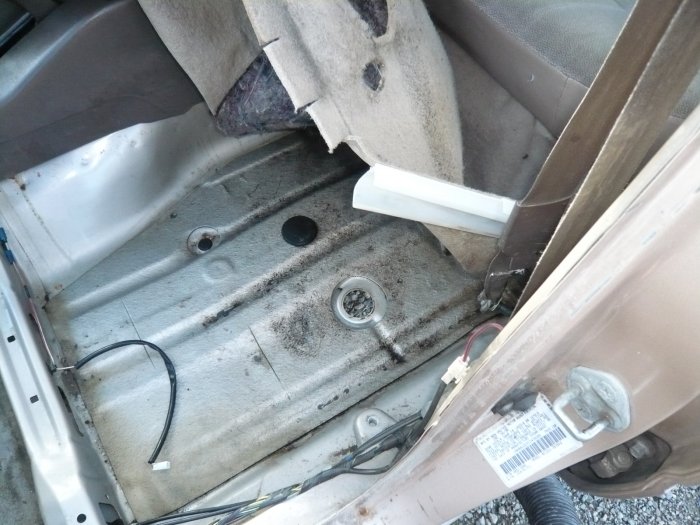

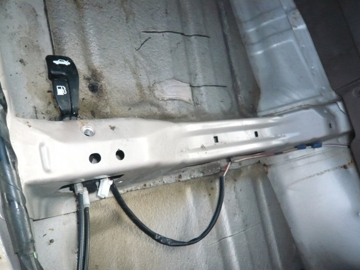

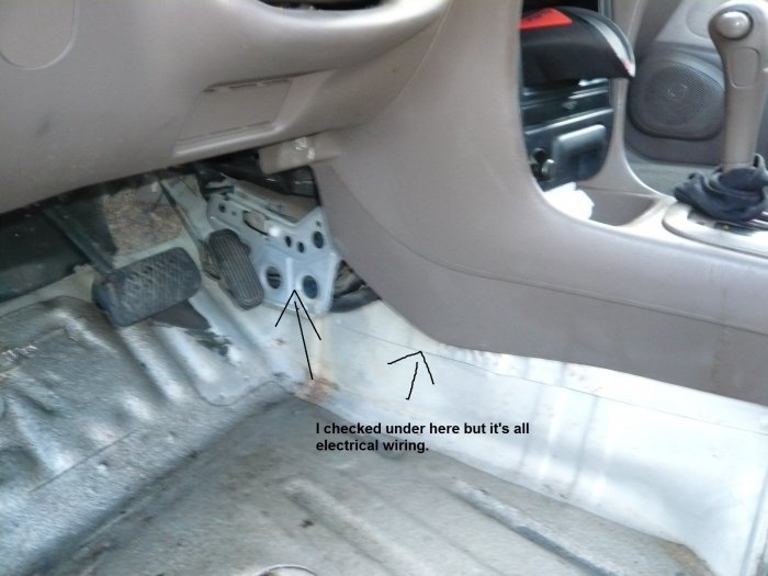

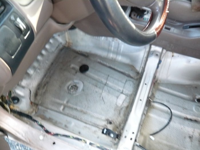

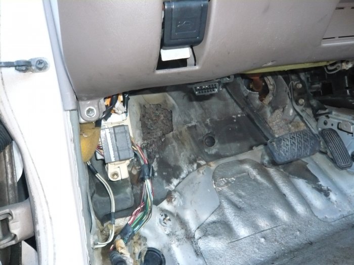

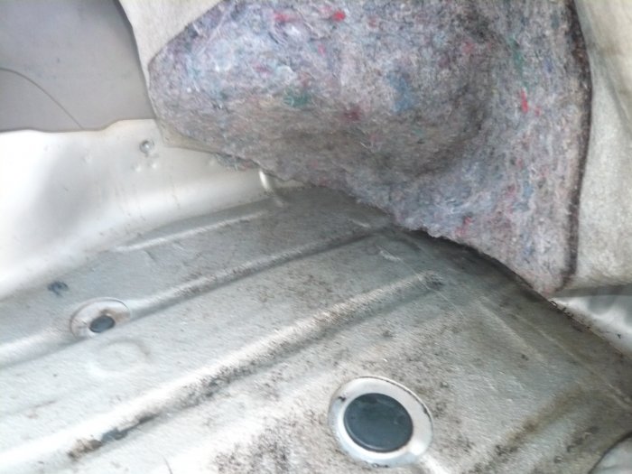

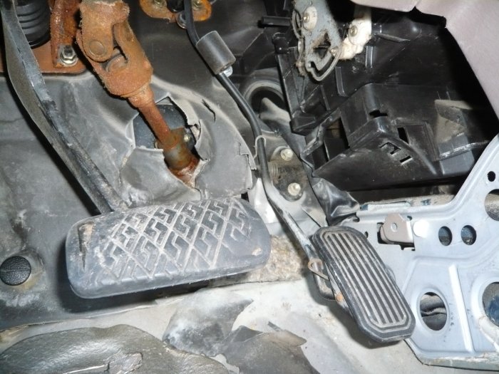

P1050756a.jpg P1050757.JPG P1050758.JPG I pulled up the carpet and pad on drivers side front and back and sucked out as much water as I could.
Now I have it all stretched out over the passenger seat and have a fan blowing on it.
Unfortunately, I don't see anything that resembles a drain hose. Here are some pics....
If you can get to the top of the carpet where it meets up with the hump and firewall you should be able to access everything. I would start in cabin before outside. That amount of water sounds like the hose is disconnected!
Just wondering if you saw the pics I posted and if you had any advice?
Yeah not sure, it should be more obvious. It is coming from somewhere but there aren't many options for water getting in. Might have to get it checked out by someone who can spray it top and bottom with water to see if there is anything sneaking in from any seams or plugs.
