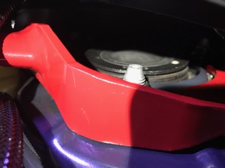

Anyone see a problem here?

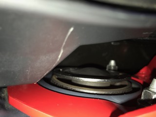

the coil spring is in upside down?? Whats going on there?

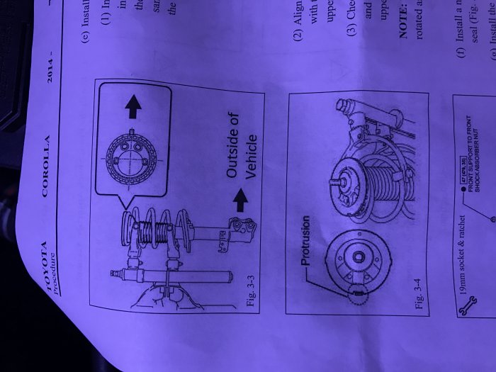

I'm pretty sure it's on backwards. There are indicating marks that are supposed to be facing forward. I can't see them at all. Springs are rubbing the body really bad on the passenger side. And they are binding up when the wheel is turned. I bought spring compressors tosometime this week I'm gonna fix it
Not upside down. But facing the wrong way. The mounting plate is directional and I believe it's on backwards. Bought a spring compressor and I'm going to remove it this week or weekend. Since I'm the best non mechanic that I know!

So when I took it back to the "mechanic", he did fix the one side but never checked the drivers side. I ended up buying that impact air ratchet. Just FIXXED the drivers side! It was also out by 90 degrees. Finally no more rubbing!!!
