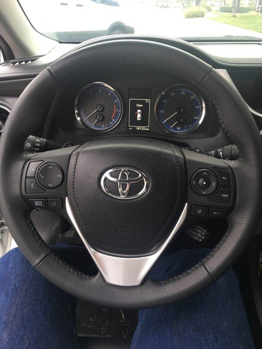

What functions did you lose? I would really like to put an aftermarket radio and get carplay. I looked on the iDatalink website and from what it looks like it only supports the prefacelift steering wheel controls.

As far as the steering controls go, I doubt there is any difference other than layout. Can you post a pic of the wheel?

Never mind, I googled it.
So you have the parking assist buttons and a multifunction D pad above them?
With another button labeled “trip”?
Since when did Corolla offer a heated steering wheel?!?
And I claim to be an enthusiast! Geez
Anyways, all my buttons (2014 LE) are reprogrammable. I even had options for the park assist, that wasn’t even available in 2014. Same goes for the radio.
I have a 2017 XSE and they have changed the steering wheel controls. The round button on the left if for radio/switch song and calling, the right is for controlling the center screen.
My stock radio is an Entune system but not the Premium version with all the apps and i would rather have CarPlay then buying and figuring out how to install a stock Entune Premium head unit.
