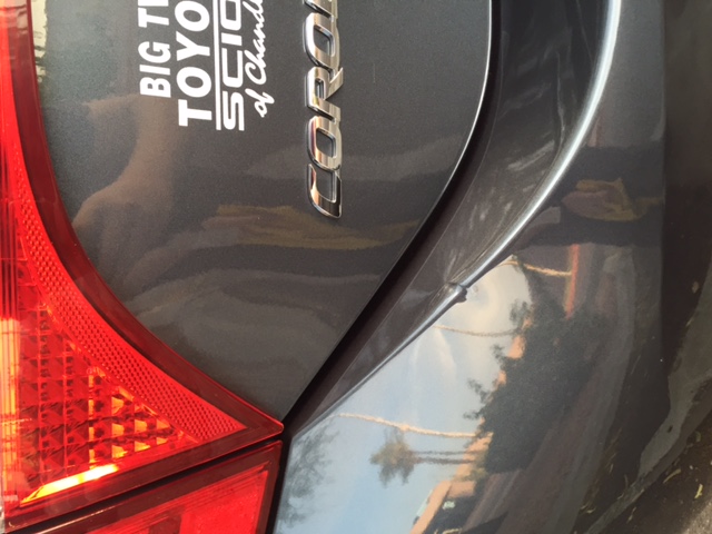

So, the guy at the car wash whacked my bumper right on the 90 degree corner/edge of the left side by the trunk lid. I want to see how I can take the bumper off myself and try to repair it. Is it really hard to take the panels off the car? I've only ever taken the panels off of motorcycles so I have limited experience but none with cars.

That's the thing though. There's no paint damage. It just needs to be popped back out. I'm hoping it comes off pretty easy. Does anyone know if there are any clips on the back side to be careful of?
This should show you where all of the clips are for the rear bumper: http://partsfactory.camelbacktoyota...gine/body-cat/bumper-and-components-rear-scat
As for removing the crease in your bumper, you could try adding heat and pushing it out from behind.
