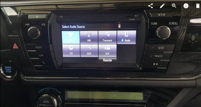

    Watch this. Who knows how to make this work? It appears capable.

    A buddy of mine discovered that you could place a dvd and his head unit would play it with the handbrake up. He has a 2014 S with navi.

    Really? I’m gonna try later. Lol

    I tried, it didn’t play. Kept saying “check disk”.

    All the screen options are there, just won’t play. I don’t know if it’s just CD or DVD player. I don’t have the NAV unit nor entune, but I’ll bet it could work on those equipped units. Maybe with bootleg DVD’s or just the older ones.

    I just check a dvd in my car and got check disc as well.

    On my entune non nav unit (100149). I just ground the parking brake pin and remove the VSS pin from the connector to go around the blue screen. You love the automatic sound levelizer function though since it is dependent on the speed signal being read by the av unit through the vss. You can however intercept a simple spst switch on the vss line to restore this. The condition for video to be displayed is that speed must not exceed 3 or 5 kph and parking brake is on.
