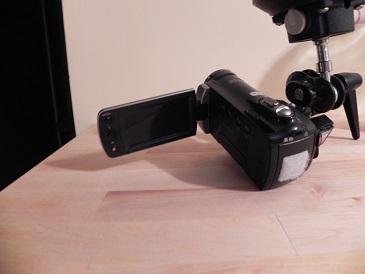

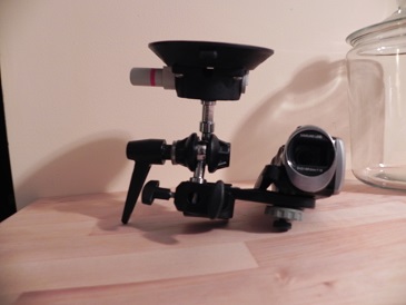

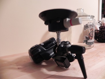

Easy to use camera
I've been using this for years in one form or another, it's simple, easy to use, and cheap. It's a samsung F90-BN with a 32 g sd card it will run for an hour and a half, but I added a long life battery and I get 5 hours run time. The mount comes from a place called FILM TOOLS, Total cost- Under $250. I got the camera and the card on black friday sale.
