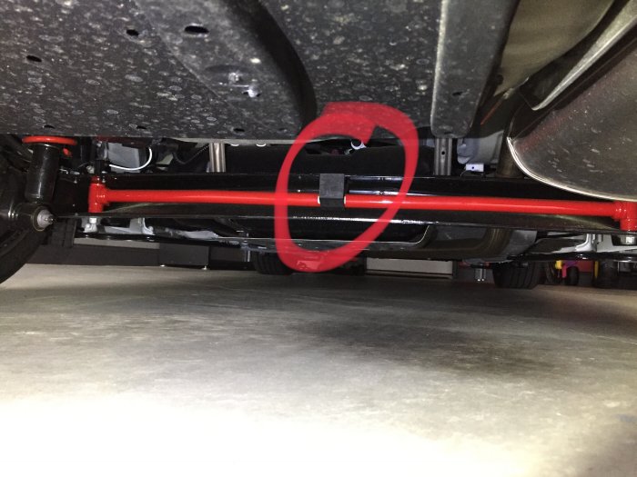

I've got about 950 miles on the car and it's started making strange popping noises at very low speeds and when backing out of my garage and into the street. The noises are coming from the back of the car and are on both sides. They DO NOT happen at highway speeds or anything over say 10mph.
I recorded this clip just in my neighborhood... the swishing is my hand on the steering wheel so ignore that. It's the noise that sounds like two pots clanking together or the dull metallic pop/clunk:

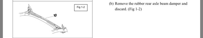

I also discovered that the stock swaybar bushing/spacer is installed in the middle of the swaybar so I'm hopeful that's the culprit since the instructions clearly say it's supposed to be removed.

Turns out it was exactly what I asked about above. The rubber damper should have never went back in and was not allowing the swaybar any movement.
