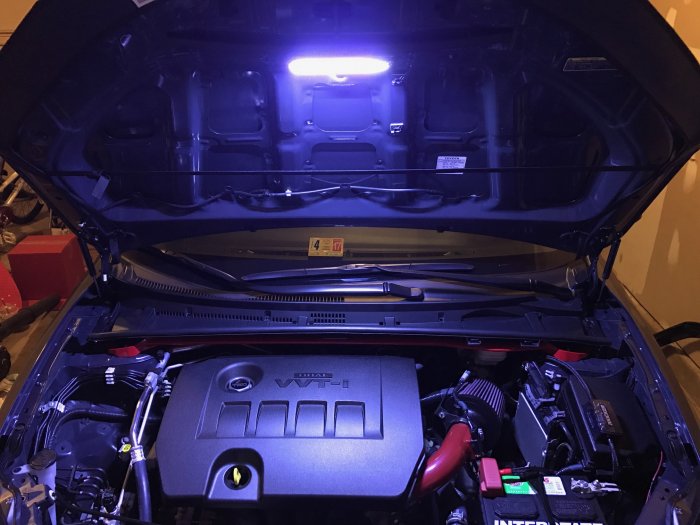

IMG_1403.JPG This is a DRL strip LED. I ran the wires through the hood so they are hidden. I have a mercury switch attached to the hood hinge. Ran the positive to the fuse box and used one of those "add a circuit" taps. Negative wire just goes where ever it's convenient. All exposed wire is wrapped in that braided flex wire loom stuff. (Forgot the name at the moment).
The whole setup only cost me about $20 bucks and I have enough parts left over to do another hood.

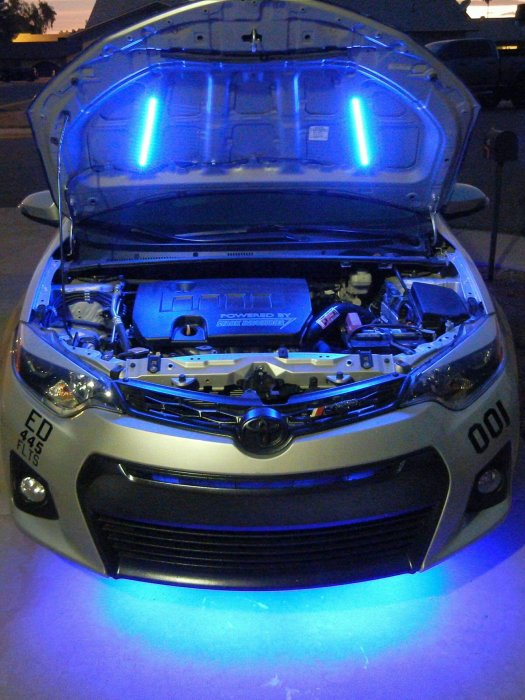

Wow very nice setups, both of you! I was picturing a setup like what @Scott Lakin has but I love the DRL idea. The link for the tilt switch isn't working though. I also happen to notice the hood struts @Chris Denton , what did you use and how did you attach them?
Yeah, the tilt switch isn't available anymore. I wonder if it's because of the mercury? I'm sure one can be found on eBay.
The hood struts come as a kit. There are little brackets that attach to the hood hinges. You will have to cut part of the cowl to get them to close or order a cowl for the Altis from Japan lol
Mercury Tilt Switch https://www.amazon.com/dp/B001TWQ0KC/ref=cm_sw_r_cp_apip_n4UXnmx4eeOBp
RioRand 2-Piece Waterproof Aluminum High Power 6W 6000K Xenon Slim COB LED Daytime Running Light (White) https://www.amazon.com/dp/B00C1YI2XA/ref=cm_sw_r_cp_apip_9hvXMYJr9L1OC
