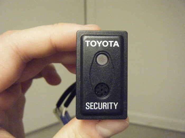

1. Is there a light for the security system when it's set? I can't seem to find it and it doesn't come on.

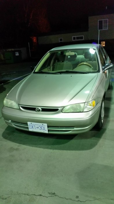

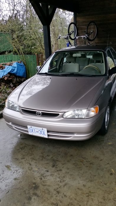

Here are some pics. I just polished up the headlights yesterday and got some nice bulbs in there, and now I can actually see more than a foot in front of me.
IMG_3764.JPG 1. If you vehicle is equipped with a factory alarm system your button should look like this. This is a picture I pulled of the Internet but it is how these generation Corollas have it here in the states. Usually located under parking brake. And it should flash when active although the light isn't too bright.

Real clean looking Corolla! Awesome!
View attachment 2202 1. If you vehicle is equipped with a factory alarm system your button should look like this. This is a picture I pulled of the Internet but it is how these generation Corollas have it here in the states. Usually located under parking brake. And it should flash when active although the light isn't too bright.
My car doesn't have a keyless entry feature, so I am guessing there is no flashing light. According to the dealership, only the ones come with keyless entry have this flashing light.
Thanks! The previous owners did a good job keeping the car in a fairly good shape. There are some dents in the rear passenger door and some other minor cosmetic imperfections, but overall it's pretty great. I read in this forum that this car can burn a bit of oil, which is what I am experiencing. I just put in a new PCV valve in recently and changed the oil today to some Pennzoil Platinum to see if anything improves.
