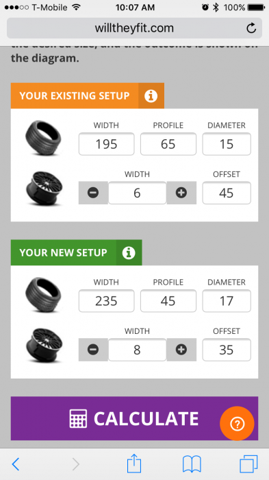

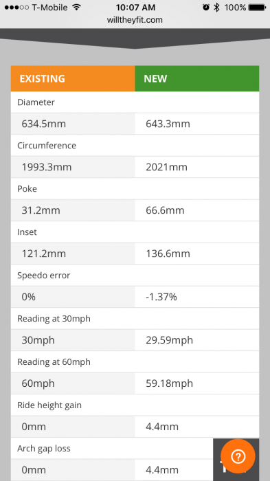

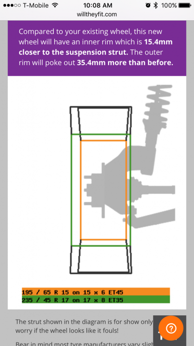

IMG_0939.PNG IMG_0938.PNG IMG_0937.PNG Hello! I'm sorry if I'm intruding but I'm having a difficult time trying to figure out how to start a new thread lol. But I have a 9th gen Coroll le. I want to get the Enkie RPF1 wheels (17x8 +35) wrapped in 235/45. I know that tire size fits fines for me but my question is wil the rim fit ?
