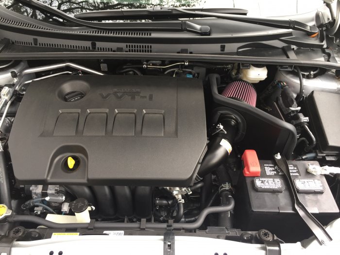

Yeah i heard k&n is good would you have the website or name of the place you got it from? And do you have pictures of in installed? I'd like to see how it would fit in thanks!
r0me0ne
not a problem, just to forewarn you it will be considerably louder in the cabin, , It resulted in a vibration in the dash, techs took out the entire dash and applied some sound dampening material to get it to stop. it only vibrated at high rpm. I wouldn't blame an intake for the vibration more so improper dash application.

My wife's driving it right now once she's back I'll take pics and it took me around 1 hour because I was doing it in the dark and had no idea what I was doing so I took my time
