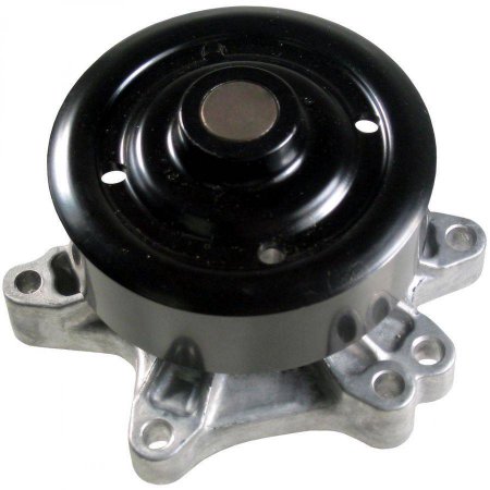

And another thing, I dont see the water pump. I mean, its fine, the car is fine and normal, but I would love to be able to FIND the dang thing (I like to see my accessories haha) so I wonder where it is?

Scrape noise could be something loose like a fender liner rubbing or something judging by your description I would not guess tires or wheel bearing due to your wording. Headliner does tend to begin to sag haven't found a remedy that permanently works yet but headliner glue does temporarly hold. Shocks tend to wear out sooner than expected and rear springs tend to sag. If your vehicle is a US model then yes you do have a timing chain. 1ZZ-FE is your engine code. Timing chain, non-vvti, waste spark ignition system and your water pump would be the pulley with 4 holes under the alternator.
