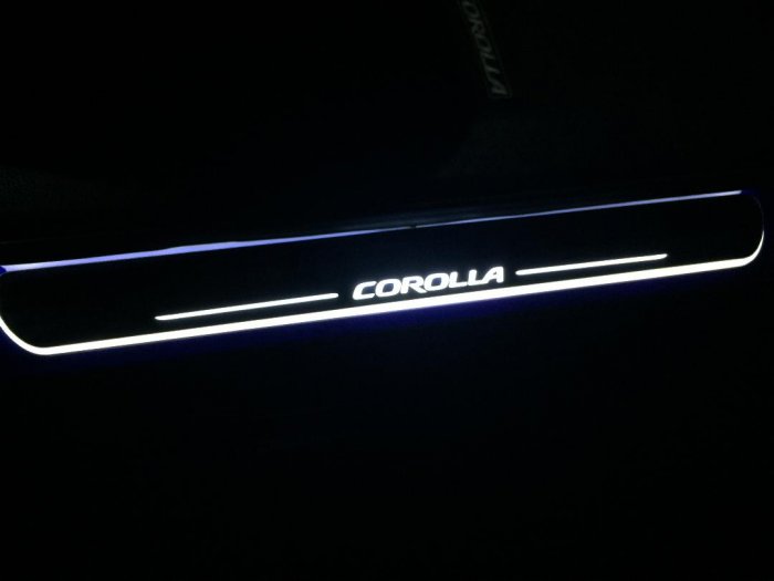

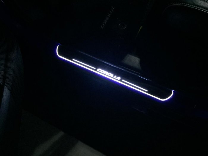

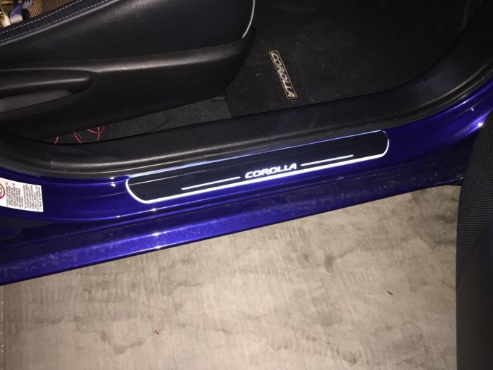

Here is the result:
It's really bright. Looks very cool when it glows in the dark.
