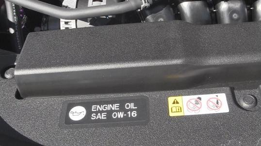

Also wondering about the oil that they use in these things -- 0W16. That stuff is thinner than ever. As the oil they suggest gets thinner, it would seem that even the slightest amount of condensation/contamination would have greater effects. I know that they rationalize it by claiming it improves gas mileage and aids cold starts but I wonder about long-term engine wear and the lubrication/protection. Perhaps they do not care as long as the car makes it to a certain number of miles -- planned obsolescence.

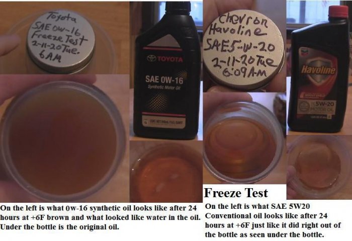

Changed the oil again today. Mobil One synthetic and filter. A little over 1000 miles. No warning lights and the car has been running fine, but when checking the dipstick it was covered in a milky froth again. When I drained the oil....the oil was a totally milky brown. Oil cap also covered in a milky froth. I don't know what to think. Perhaps I should I have just left the oil in there and let the chips fall where they may. If she blows, she blows. This car is obviously still under warranty for quite a while. But I would hate to be stranded away from home in our remote, harsh environment. Stay tuned......
#27
Temps still well below 0 nights. Teens days.
This is very strange to see the oil look like this so quickly. I'm curious what happens when the temps rise even though that shouldn't make a huge difference.
