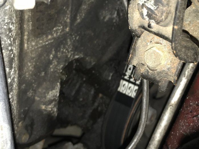

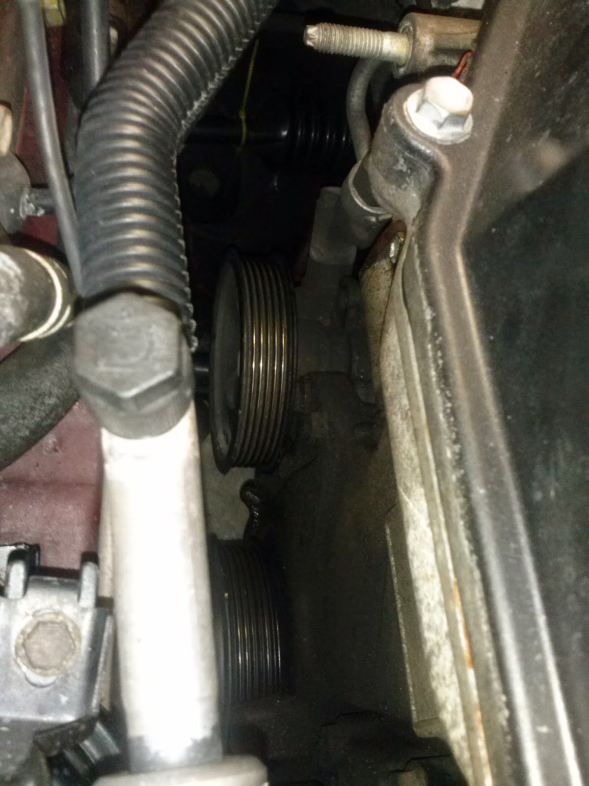

Cause if you can see in the photo below what the nut screws on two has a torque bit on the end , So that tells you that the thread part can be remove and replaced . Kind of like the exhaust manifold bolts sometimes you can pull the nut with the bolt thread
So this is inside your block

I'm not saying it isn't doable but it is a pain . So why is the belt tensioner missing ?? Do you have a photo of what it looks like ?
Maybe by looking at it I can see if it can be fixed
I’d love to get the bolt drilled out and put everything back the way it was. I saw a DIY with a right angle drill, 2 different bits and voila, good as new.
I believe he shifted the alternator forward towards the front of the car because I can see that something was altered. Now I’m stuck on what belt he used. I am sure I can find same belt by looking at the engravings on the belt.
