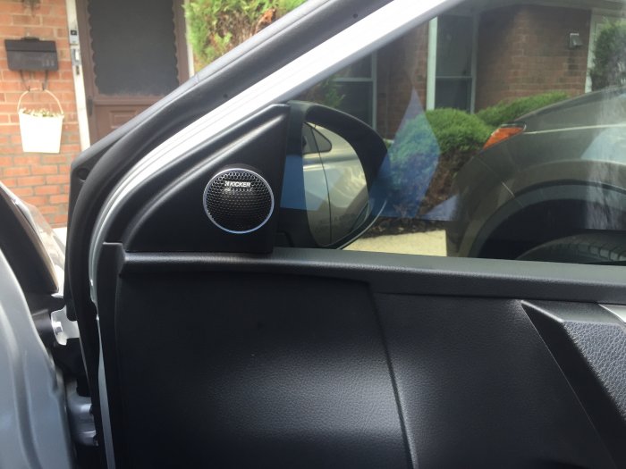

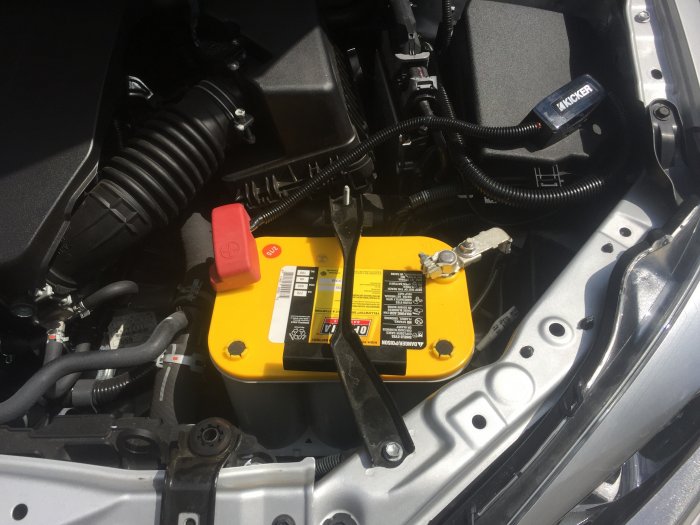

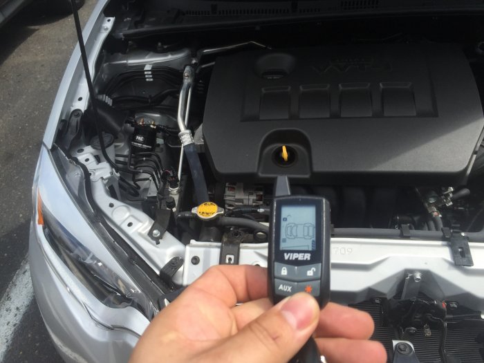

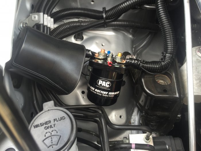

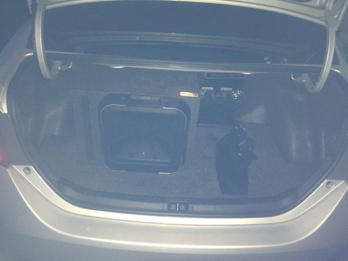

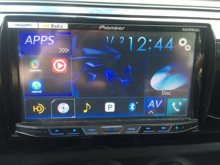

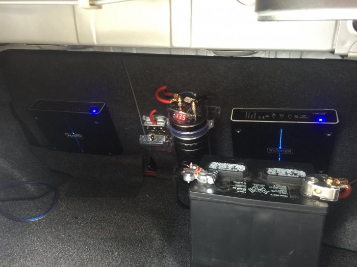

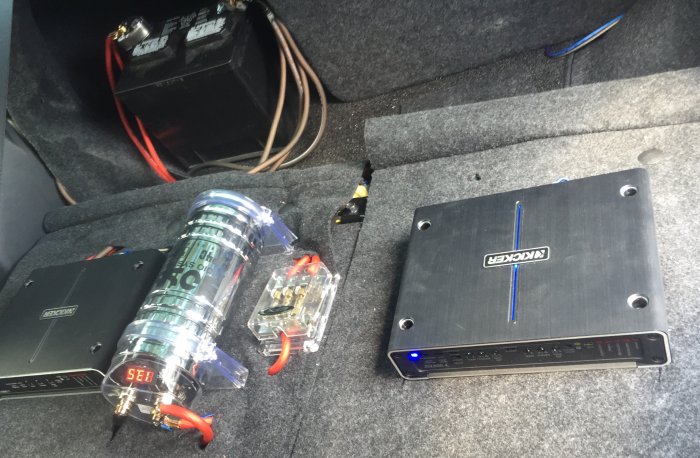

This is what I done to the car and replace
New car battery $289
Viper alarm $399
Invisibeam field disturbance sensor $25
Audio glass Break sensor $20
Isolated relay that is connected to a 2nd battery for audio and. Alarm leaving primary battery
Car only, that way my two amp wouldn’t drain front the primary battery will the car is off $450
Kicker amp IQ 500.2 $489
Kicker Amp IQ 1000.1 $700
Capacitor $78

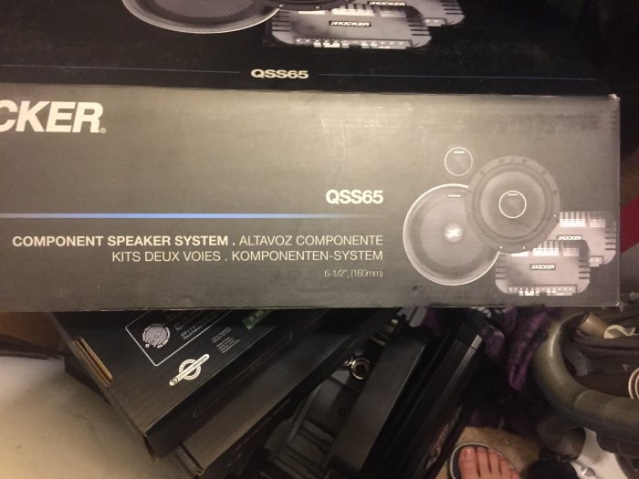

Kicker QS Series components 6.5 inches $490 front door

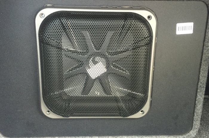

Kicker solo baric L7 10 inches 2 ohm 199
Box for subwoofer $45
Pioneer stereo AVH-5700BHS $520
Pioneer 6.5 mid bass drivers pro series $120
Kicker wires kit $120

Looks good except that battery in the trunk, that sucker has GOT to be vented, or you're going to inhale a lot of fumes you don't want to, and everything in the car will corrode at a pretty quick rate. It's going to offgas, just by the nature of the battery, if anything, at least put the Optima in the back. At least it's a sealed cell battery and no risk of turning the car into a roman candle.

Very nice setup u got there. But I also think you should move the optima battery in the back n the stock back in front so it can vent the gasses out not in your car.
