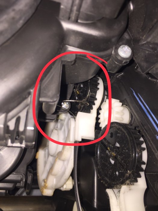

55BB5B28-F5D5-4107-8397-8471650CB507.jpeg This is my situation looking underneath th glove box my vent mode cable is off the wheel at the damper. I know they sell the cable($40) but I cant figure out how to take it off. Everything moves free by hand.
View attachment 3854 This is my situation looking underneath th glove box my vent mode cable is off the wheel at the damper. I know they sell the cable($40) but I cant figure out how to take it off. Everything moves free by hand.
I took my front dash apart which was very easy. And thank goodness the cable is just off the hand control I easily put it back on and I added a little bit of silicone grease and I’m back in business. Here is a link to a good video.
