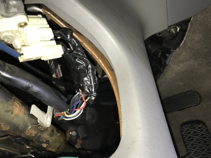

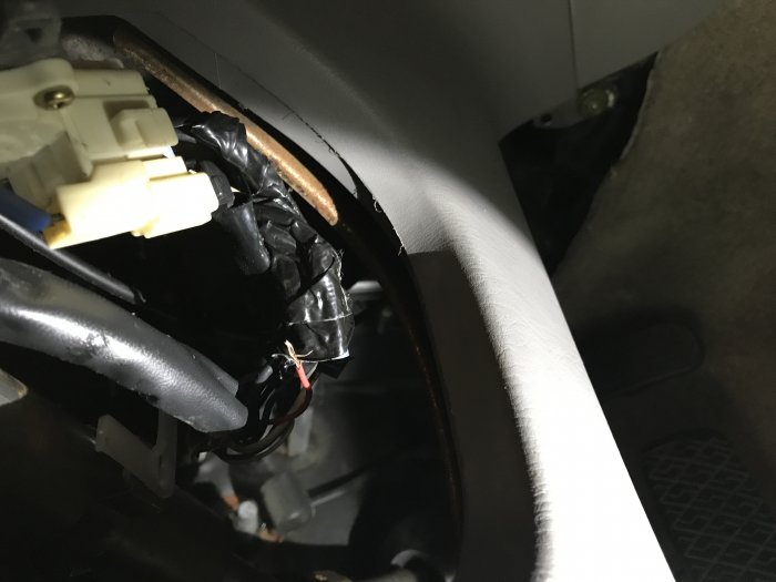

Huston we have a problem!
I took the top plastic cover off of the steering column so that I could see the wiring and found this little red wire disconnected. This wire was connected to a cheap wire connector, someone worked on this wire at sometime. The only thing that I can think of is they put some sort of alarm system in it or something. So tomorrow I will cut the electrical tape away and see what I am truly dealing with in the bundle of wires....

:eek:
Looks like someone might have had an alarm on it. The wire bundle is garbage! I didn't have time to fix everything that will be a project for another day. I did solder the wire together and heat shrinked it. At least now if I have a problem with it I know where to start.
