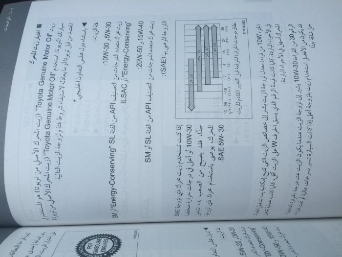

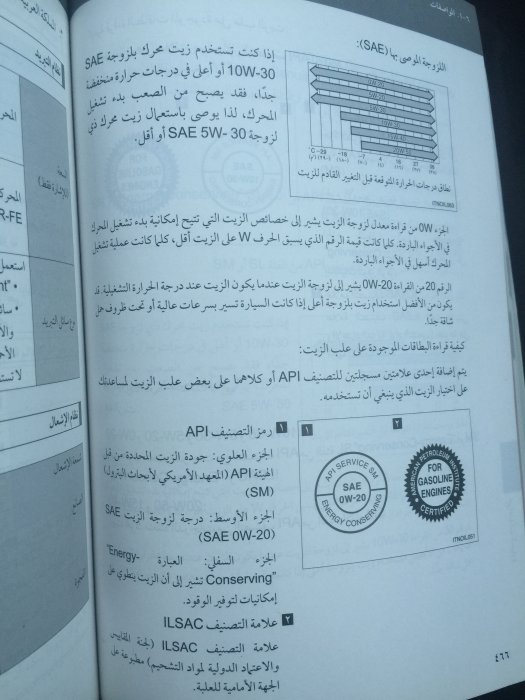

Of course I have the original Toyota owners manual book let , & as you can see the pictures I took from it there is nothing I guess specific to guide for as shown in the right page for the right oil kind .!!!
