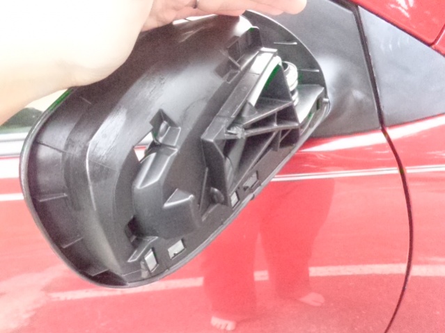

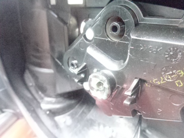

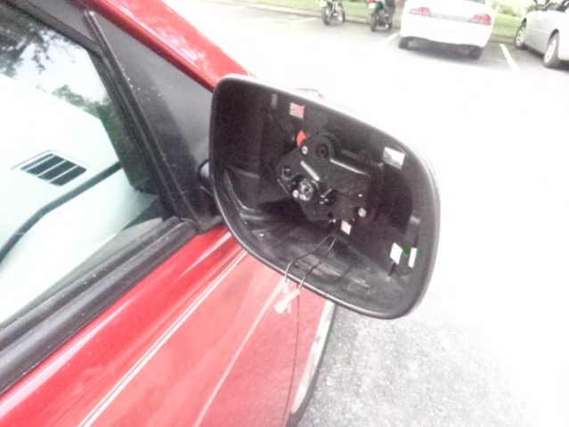

Hello--due to impatient and angry city drivers, I was forced off of the road getting on a ramp and kinda sorta clipped a traffic barrel. Nothing was hurt except my right mirror, but only the glass itself and the cover were damaged. I have pictures--but is it possible to only replace the mirror and cover, not the entire mount? It seems completely fine, the motors still whirl and all that, the things that hold the mirror in place seem fine. Where would I go to order just these things? Am I missing anything?

The dealership parts guy told me that as long as the clips on the actuator aren't damaged, you can but the mirror part that clips onto it. You can also buy the cap separately. In my case on of the clips on the actuator was broken, so I had to buy the whole mount...200 bucks.
