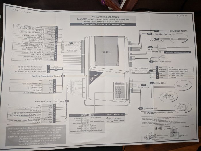

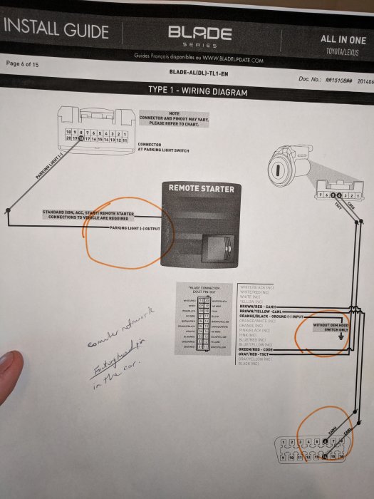

doing my first remote start installation and it's on a '10 Corolla CE. Have a couple questions about the wiring diagram and wondering if you can help me out.
On the wiring diagram it shows the (-)Parking Light wire tied into from the remote start module but my problem is I can't seem to find the parking light(-) output connection on the remote start module...
My next question is, on the same wiring diagram, this time to the blade connector pin-out, you see the orange/black - ground (-) input connected to ground if I don't have an OEM hood switch. What exactly is an OEM hood switch and how do I know if I have one?
Lastly, on the bottom right of the diagram you see the connection to CANH and CANL, where is that connector located in the car, does anyone know? (and what is canh canl and txct?)
