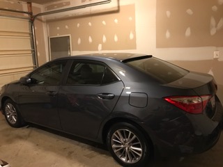

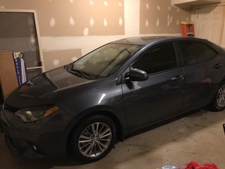

So the real question is, black or silver?
My Corolla is slate metallic so I think I'm going to go with silver. Dark car light wheels.
I have slate metallic as well, it's a great color until you realize that it doesn't seem to match well with most others! I'm torn between silver or plastidip bronze.

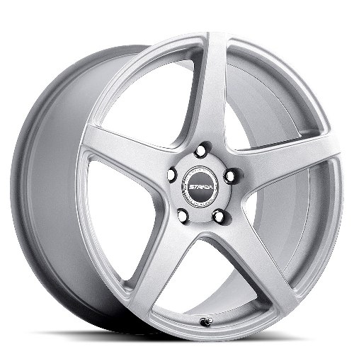

Depends on how much I have by 40-45k miles -- ideally, I'd like to replace wheels and rims as well. These Strada's look incredible, but can our cars go up to 18? My rolla has the stock 17inch steel alloy rims on it right now. What kind of issues would arise from going up to 18inch?
You can go +2 and keep the same wheel diameter. I want 18's cause the tires are easier to find. (at Costco lol)
Wait, wait, lemmie get this straight:
You can put 17inch diameter tires on an 18inch set of rims?? Wouldn't that cause some stretching? Or are there specific rims that can do that? Just want to confirm because I really, seriously don't know a thing about this when it comes to wheels. Lets say, hypothetically speaking, I picked up those Strada's you posted earlier and the set of BFGoodrich GeForce Comp 2 All Seasons that Drainnoodle recommended. That would work without any tweaking beyond balancing and rotation??
No. You need 18" diameter tires for an 18" rim. What I'm saying is that due to the sidewall height, you can get the same overal wheel diameter. This will prevent the speedometer from being off. Example, my car has 16" rims and the tires are 205/55/16 so the overall wheel diameter is let's say 20".
If I buy 18" rims and install 245/45/18 tires, the overall wheel diameter would be roughly the same 20".
So I went plus 2" up on the rim and minus 2 on the sidewall. The middle number in the tire measurement is the sidewall height, measured in metric.
Hope this makes some sense.

Ahh, okay, that makes perfect sense -- the tradeoff to bigger rims is a smaller sidewall. I wasn't aware of what the numbers (205/55/16) meant either until you pointed it out. Thanks, I'll definitely have to figure out the numbers for the tires that I've taken a look at so far and figure out which rims I could get that would work with them and vice-versa. Very Helpful Award of 2016 goes to Chris!
