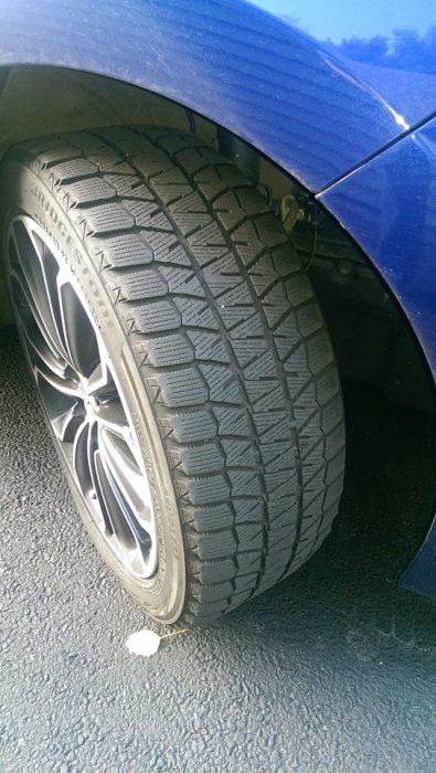

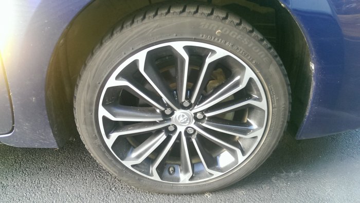

Have 2014 S and the tires that came with it absolutely sucked in the winter. Put a set of Blizzaks on it and what a difference. In a emergency situation I guess I would give this a shot. But being in Maine you got to be prepared for winter emergencies.
Does the "S" have different tires than the other models? I know the larger wheels are an option.
rhe
The S, LE, LE plus and LE premium come with 205/55 R16 and then the L and LE eco come with 195/65R15 but the S Plus and S premium come with 215/45R17.... granted the overall tire size radius is about the same size between all models but the thinner sidewalls greatly reduce what tires are available for it.... i had a 2012 focus titanium with similar size as the S premium and was hell to find a good all season that went well in the Maine winter... So with this S model ive run either winter tires then swap over to summer performance tires or just run the blizzaks all year.... they are supper stick tires but a bit loud... they are real good in the snow and rain and mud/dirt roads
