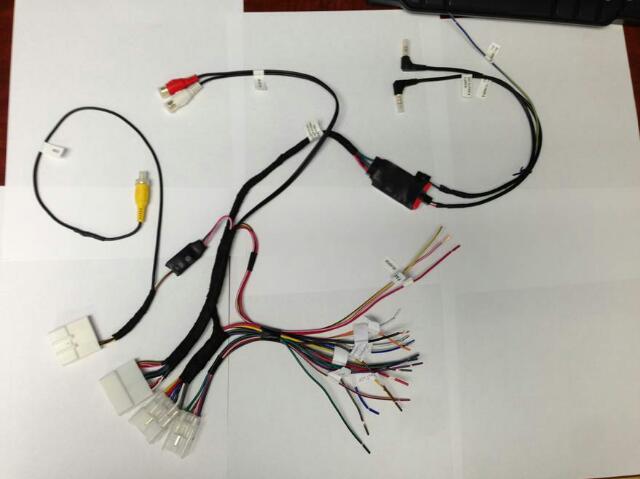

Newcorollaowner - what are the red and white RCA's for? (And you said you were going to post a link to the company for this!!!)
I don't know I haven't even gotten the harness myself I sent my credit card information via the companies authorization form but they still haven't taken the money for the harness and far as I know haven't shipped the harness as of yet either as soon as I get the harness and see how it works I'll post my results and information on the company and everything.

@newcorrollaowner - I'm pretty sure I know what the RCA's are for ...
They probably allow you to use the Toyota AUX input with a receiver with rear RCA INPUTS.
Metra has a 70-8114 Harness that does the same thing.
New question - As I understand it (I have an E-mail in to Metra), they have a 71-035LC wiring adapter that connects to the woofer plug in the front door and is a good solution for the 4-speaker cars.
If you have the six-speaker cars, the woofer is wired from the tweeter, so you either have to cut and splice the tweeter wiring or run new speaker wire to the front doors (which defeats the purpose of the speaker adapters).
Could you check with the harness company (or does anyone know of a solution) and see if they would be willing to make an adapter harness using the tweeter input connector for speaker wiring?

Ok I'm seeing if he can make the tweeter harness and to see how people can contact them to buy the harness he made for me. How and where would I need to post this for other corolla owners?

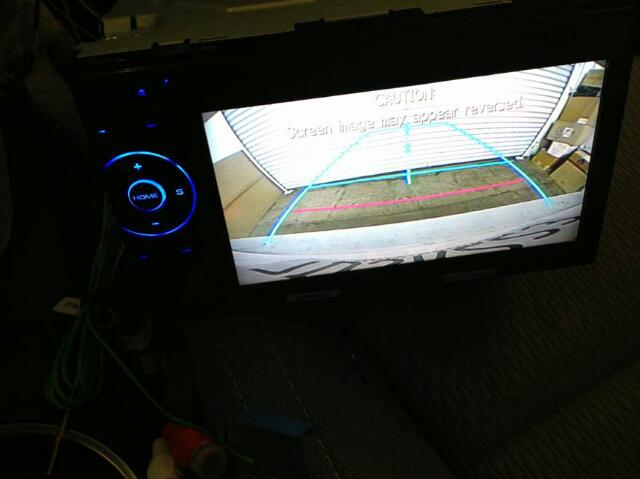

First and foremost, you want to make sure this works!!! I know the pictures show it working and I assume the company might have used your camera and your head unit to test it. But there is very little worse than making a post and getting say 10-15 orders for these, and then finding out it won't work with some cars and having to refund customers money (and then the company gets a reputation for not making good products and the fact that the initial ones were bad and the later ones were great doesn't matter).

It works great the backup camera works and the steering wheel controls minus the Bluetooth work it's supposed to work on all brand of stereo's including Pioneer, Sony, Kenwood, JVC, Clarion etc I'm waiting to hear back about the tweeter plug and how for other's to order the harness they made for me.

I'm more interested in the radio harness than the tweeter plug, although both would be nice.
Also - I think this could end up being VERY lucrative for him. Metra only makes a rear view camera interface for a couple of GM models and RVC is going to be required on all USA cars within the next two years or so ...
#49
They said he's on vacation until 8/7 but and they'll be releasing the kits around that time. I love the kit I love having my camera working with my Pioneer and having my steering wheel controls working again minus the Bluetooth microphone. I have pictures of my setup on my profile.
