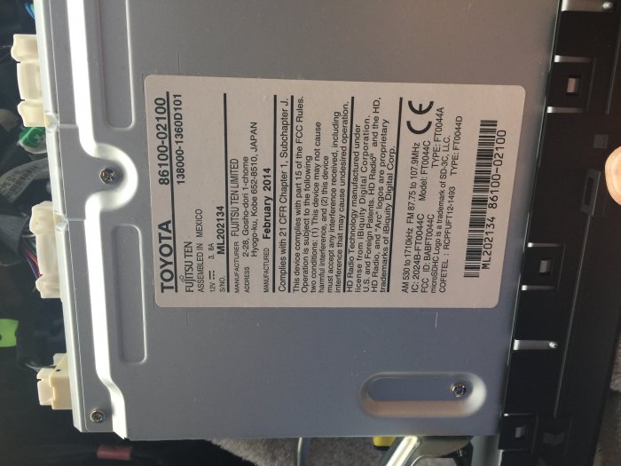

Did anyone find a solution to this problem? I now have this issue with my 2014 Corolla with 78k miles and no more warranty. You would think a radio would last more than two years!
This problem started for me just this last weekend. I called entune customer service and support who told me I needed a firmware update. I got it to the dealer on Tuesday, after I tried several things myself. Unhooked the battery, took the dash off as suggested in the video, unhooked and re plugged in everything. Still no success. Dealer also says I need a new system and they can't update the firmware. I notice my USB doesn't work to charge my phone which might be significant, but I don't know. I have had this car less than a year. I'm also out of warranty with only 43000 on my Corolla. All I can say is I'm disgusted with the service I got from the dealer I took my car too. I know that there have been several people with the same issue. Please post if you find a solution.
interestingly enough, the manufacture date on the system is February 2014. My car is a Corolla 2014 S
