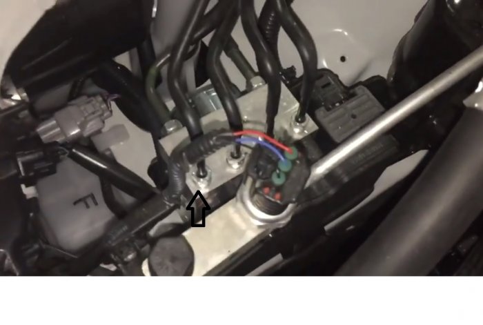

hi guys, i inspect two days ago there was leakage and i have no idea what are these wires and what's for it. can you please tell me it's only leaking from only one connected wire or i should take my car to dealership for service? the pictures are attached thanks.

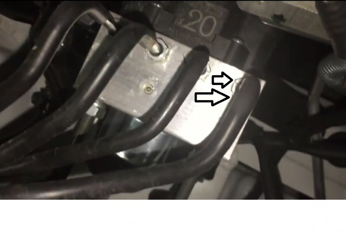

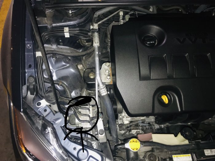

As you can see there are four black pipes and i mentioned with arrow that pipe was leaked when i checked. I guess it’s called ABS module. Is it normal because there is no ABS light on and it’s been a week there is not leakage yet or i should take my car to dealership to get it checked? Thanks
That's the ABS pump. It's more than likely brake fluid around that fitting. You can try tightening it up. I would wipe it down and see if it comes back. If so, I would consult a mechanic.
Dont over tighten it, just snug it up.. check your brake fluid level too
That's also under the ac line if I'm not mistaken, could be condensation dripping
