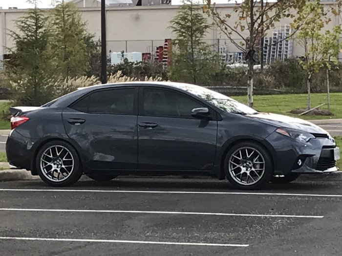

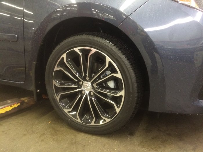

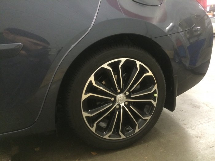

Eibach and TRD are nearly identical, I have heard the TRD are just recolored/ branded Eibachs. Here is my car on Eibachs though
How big are your rims? What brand are they? They look like my Motegi Racing MR127 lol. I was thinking about lowering my car too!

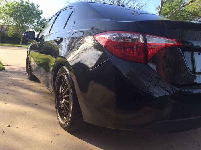

As far as springs at least for me, they were cambered a lot more than with my coilovers especially in the rear. Some coilover setups can camber in the front but nothing really in the rear unless you use washers, but that’s pretty risky. I know of someone who’s actually having a camber plate made for his corolla to replace the washers in the rear.

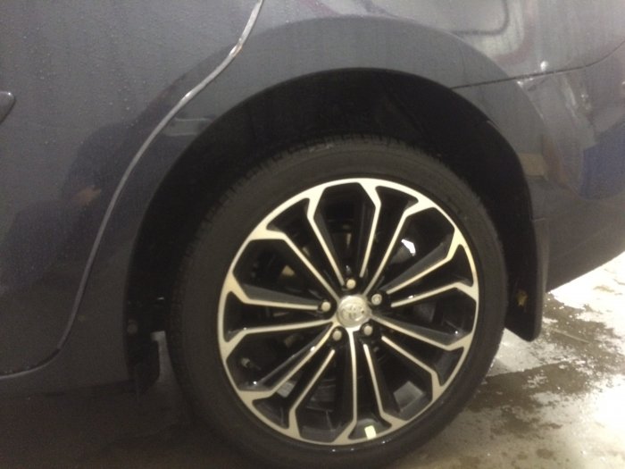

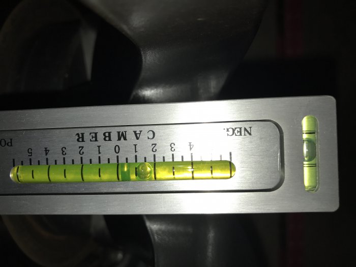

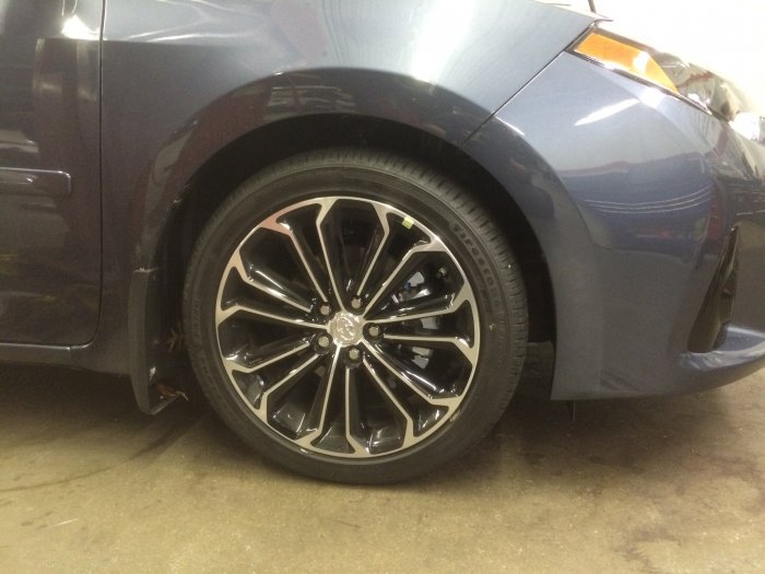

This thread has me concerned. So I checked mine again last night. With TRD lowering springs and 18” wheels, I’m at +1.5 in the front and +2.5 in the rear. (This camber, not to be confused with ride height.)

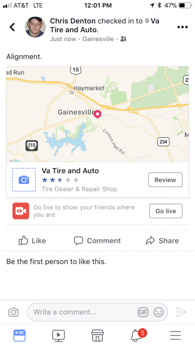

So, once it stop raining, I’ll be taking it for an alignment!

The camber was good for factory specs based on 215/45/17’s. I guess that’s as close as they could get to the correct wheel size? Doesn’t matter since the overall size is the same as my stock wheels.
They did adjust it though.
What surprised me was that the toe was out.
As for the rear... no adjustments can be made. Very minor if any. But was in specs.

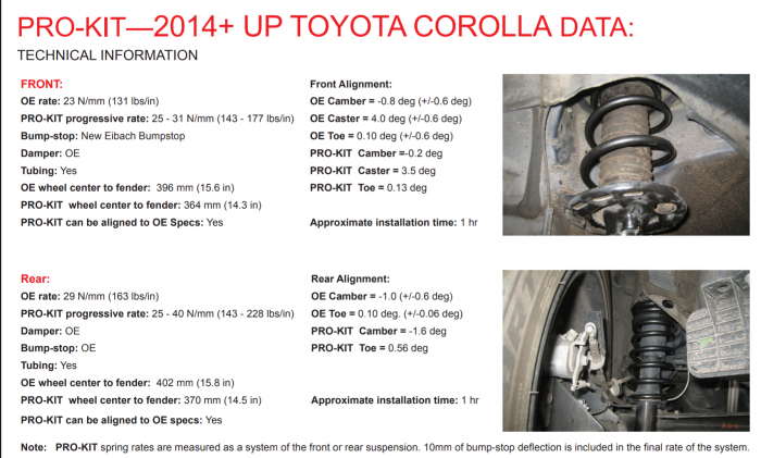

This information was taken off of the TRD springs installation manual.
Camber:
-0°35’ +/- 0°45’ (-0.58° +/- 0.75°)
Toe:
0°00’ +/- 0°12’ (0.00° +/- 0.20°)
0 +\- 2.00mm (0 +/- 0.0787in.)
Standard difference 1.5mm (0.0591in.) or less.
This is front wheels only. There are no specs for the rear.
#31
Got this from the Eibach pro kit for 11th gen Corolla with rear toe and camber specs. I wonder why there is a difference vs TRD specs on the front specs? Front camber is almost the same. But toe doesn't match. IMG_20180312_163946.png
