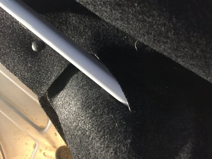

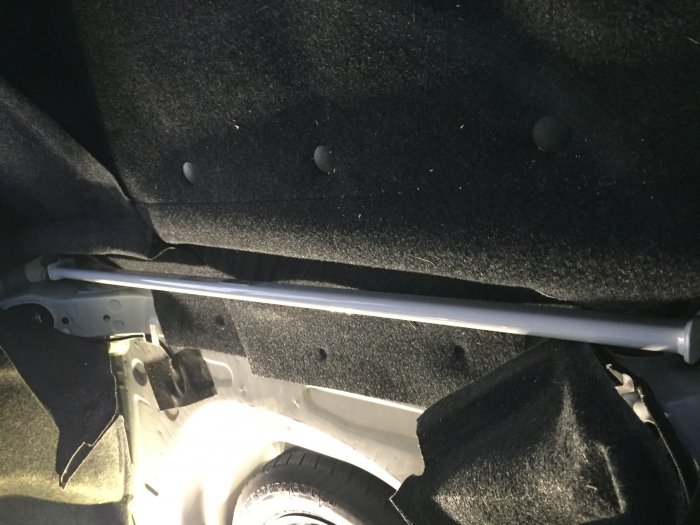

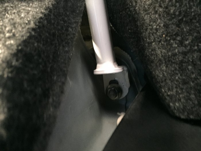

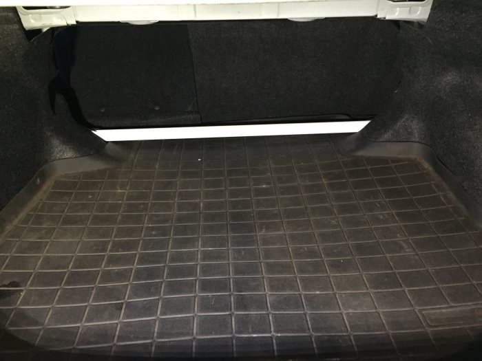

UR Rear Strut Bar install. Removed everything from the trunk and then laid the back seats down. Removed the 14mm nuts with my impact gun and put bar into position. Reinstalled the nuts and torqued to the factory 28 ft lbs. I cut the carpet to give it a nice fit and look. Haven’t test driven it yet but it should help.
