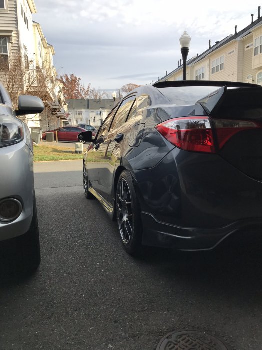

When I did that I had the 2" Drop Springs from Megan Racing. If you go look at my instagram 2k16rolla_s , a ways down you will find pictures of my car with black stock wheels and 25mm spacers in the rear. Now I have BC Racing Coilovers and wheels are 18x9.75 +20 offset. No spacers now, just a big offset.
*EDIT* This is a link from my instagram with the photo: http://instagr.am/p/BNQYRokgeQv/

Ok, so you can go larger than what I just posted. Do your front tires rub in turns?
Following BTW, I see your tires are also stretched.
I only rub when I hit dips or bumps in the road. I had to roll the fenders and cut out a chunk of the front fender liner but now its fine.

When I measured min 2017 XSE, these are these are the same measurements I came up with if I were to add spacers. The photo you posted shows a nice end result.

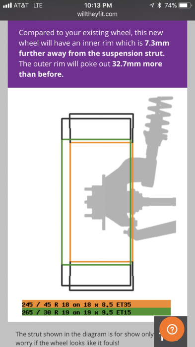

View attachment 3429 This might be what I go for next.
You'd need modifications on your wheel well to run that size and offset.
If the goal is most wheel poke without rubbing on the wheel wells, you can use a baseline offset of +30mm using 235/40/R18 tires on 18x8 wheels. Any lower and you risk tire rubbing during dips. As you increase tire width, you want to increase offset by half of the increase in tire width to maintain fender clearance. Stretching your tires by using wider wheels may afford you an additional 1 or 2mm lower offset but ymmv.
