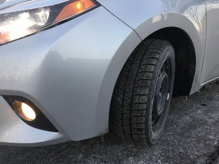

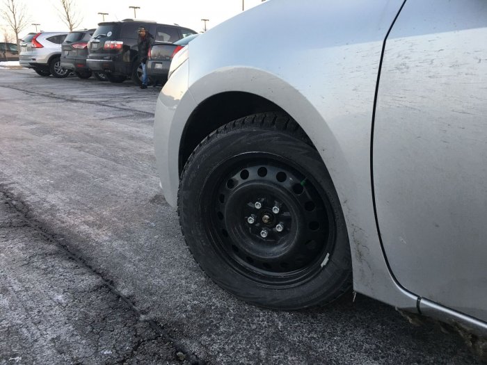

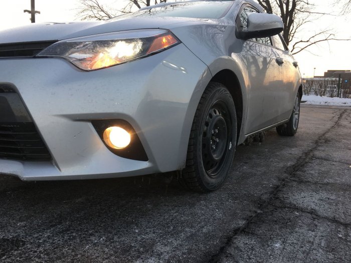

Posting few pics of the wheel, tire combo I got.
