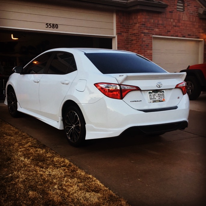

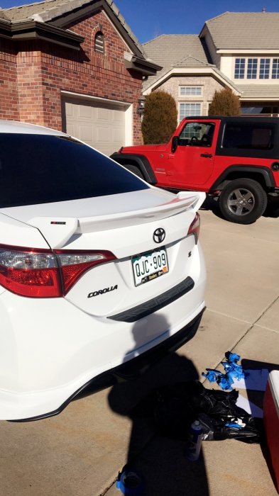

It's a great spoiler it looks great. It was smaller than I expected. It is as long as the bumper. It is a bit heavy for the trunk. When you open the trunk it won't open all the way like it would normally. It only pops open and I was a little disappointed in it. The wing stays on great I had to get longer bolts though. It comes with predrilled holes that are threaded but you have to drill your own holes and it is annoying. It took my 5 hours to do mine because taking off the S spoiler then drilling the holes sucked. I ended up getting one of the blots they gave me stuck in the trunk and it took a while to get it out. What I recommend is to make the holes that are on he outside of the trunk smaller than the head of the bolt but make the ones on the inside of the trunk big enough for a washer and bolt to fit in. It makes things a lot easier trust me. Also what helps is to tape out where you will drill. If you have an S the spoiler is terrible to get off I can explain more on that. I hope this helps

Interesting. Smaller than expected? Could you perhaps post some photos here for us to see? Yeah we've all seen the Mapisa photos but how about some closeups and unusual angles? All of their photos are same angles and far away. I'm trying to decide whether to get the Z spoiler or not too. I can't decide!! Thanks!
