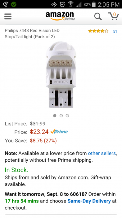

To remove the clips I used a small flat head screwdriver to pry out the clips. I think there's a video on it on YouTube. These r the leds I got for it. Screenshot_2015-09-07-14-05-23.png
