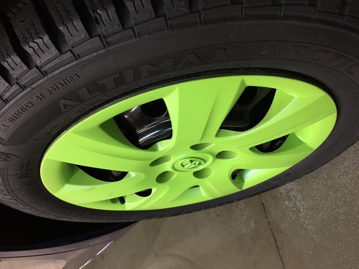

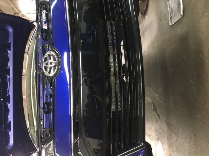

So after getting snow wheels and tires I wanted to make my car different again. So I plasti-dipped some Camry hubcaps. 4 coats of lime green, 2 coats of blue Pearl, 2 coats of clear. Then a week later I installed a light bar behind my lower grill.

Nice, loving the light bar. Got some more close-up pics of how its installed?

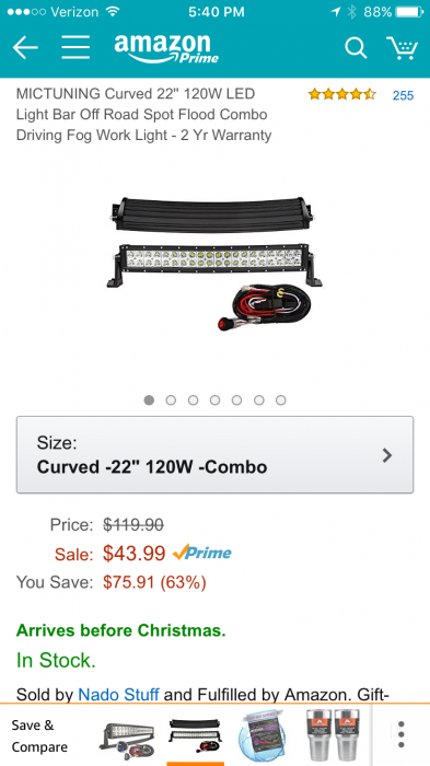

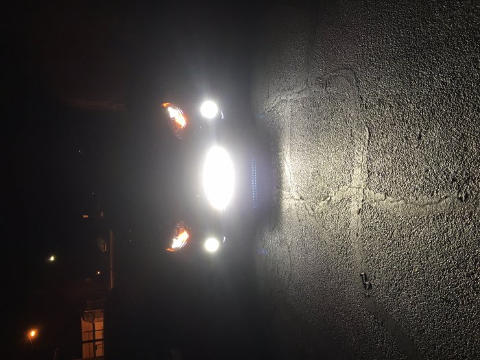

I was thinking about installing a light bar in the same place! I guess you beat me to it! Haha. Can you upload some pics of how much the bar lights up the road? Also can you post the amazon links?

So It might not be the best light bar but it is CREE and super bright. And it's actually not a bad install. I actually just took off the splash shield and lined it up on the bumper support with the brackets and drilled holes. Then tapped the holes and mounted it. But figured I would go the extra and pulled my bumper off and fed bolts through the support. I had to customize the nuts a little but it turned out pretty good. I didn't think about taking pictures till I was already done.

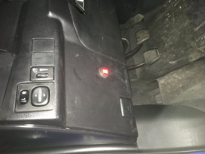

How difficult was the wiring part? Did you have to drill or use existing passage through firewall? Did you install interior on/off switch or using existing fog lights controls? I like the fact that it's hidden and no one can steal it etc... On the other hand looks like a paint in the a$$ to take the bumper off and everything. I would probably consider one with one row of lights and see if it's doable without taking bumper off.

wiring wasn't bad, I ended up bringing the wire up where the horn is and behind the drivers headlight. Haven't completed the install of the relay and fuse but I have it wire tied. I went through the firewall where the main harness goes through and I mounted the switch on a kick panel. I'm pretty sure this light is illegal to have on because of how bright it is. And the bumper is easier to take off than the splash shields.

Not illegal. You are allowed to have 5 driving lights. Which I usually just drive with the headlights and lightbar. I have actually talked to cops about it. They said it's low enough to not be a problem.

nice, well, i don't really like the color of the wheels, but everything else is phenomenal ! i like how you installed the led light bar, clever. i've seen other drivers have it installed on the outside and it looked funny. what did you use for the wheels though , ill probably do this on mines but in a different color.
#43
He's got some OE steel wheels, with plastidipped wheel covers.
