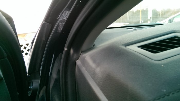

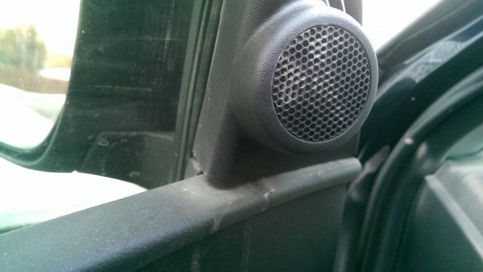

anyone else getting a fair amount of dust coming in from the mirror on the door.... its not from the heater vent but right above the door card and bellow the tweeter and triangle trim piece... happening on both doors... Happened on my 2014 S, and now on my 2017 xse.... i havent taken a door card off in a long long time but they used to have plastic between the door and card..... just wondering....

They checked my cabin air filter thinking it was blowing out my defrosted and building up in the corner but the filter was pretty clean... I don't know if theres plastic barrier where that plastic trim is like between the door and door card... We put so much sand on the roads up here it's hard to tell if the roads are dirt or pavement.

Are all the seals in tact? Are they clean? Is the mirror tight?
Also, I suggest this to everyone, clean the rubber seals regularly. You can use Mothers VLR, Mequires, Armorall, etc.
The idea is to keep the rubber pliable.

Is the dust appearing only on the driver's side?
Is it possibly being blown out of the side window defrosting vents located on the dashboard? The pattern of dust deposits in the tweeter holes looks odd. On the other hand, if the tweeter membrane is torn or otherwise damaged, that might be allowing dust to be sucked into the cabin.
both sides, dust and when it rains i get moisture there also... waiting on Toyota tech from Boston to email me... the last few Toyota shops i been to have been scratching their heads....lol

If there is moisture there as well, I'd think the weather stripping on the door may be loose. There is also a water protector thing behind the door panel that usually blocks water that gets inbetween the door shell and glass from coming in. Maybe yours has a gap in it or it's torn (it's a plastic sheet that's glued onto the door frame). The only way you can find out is by taking off the interior door card and seeing for yourself.

I took it to Toyota and they tested all the seals and seemed fine they said, waiting to hear back from Toyota tech in Boston, I get moisture too... I mentioned the plastic and maybe none behind the mirror, when it warms up I'll tear it apart... We just got 18 inches of snow Thursday so it's a tad bit cold for my gimp ass to look.

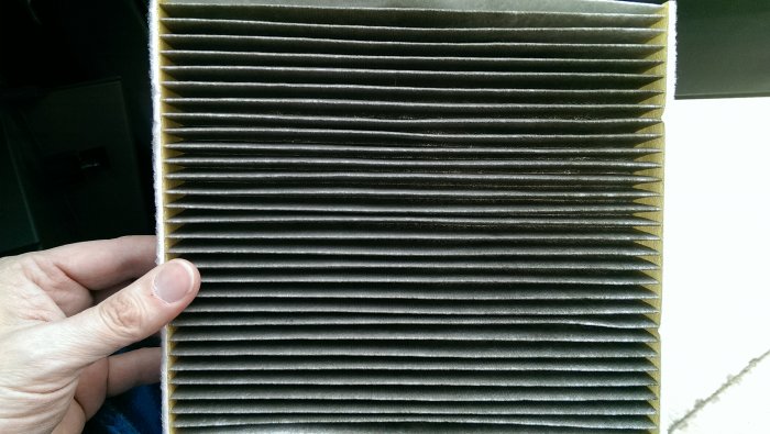

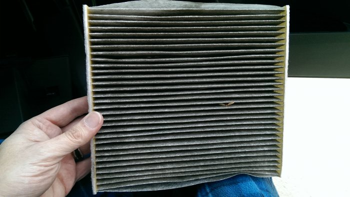

I noticed alot of fine dust on the sides of my seats the other day and Toyota was still clueless as to why, so I said screw it and bought a k&n cabin air filter... I cleaned my car spotless today so let's see if this helps... This looks like it hasn't been changed for 38,000 miles which the Toyota tech said they did twice.... It had flyin insects and we've had six solid months of cold winter... Ain't no flyin bugs in this weather... IMAG2171.jpg IMAG2170.jpg
