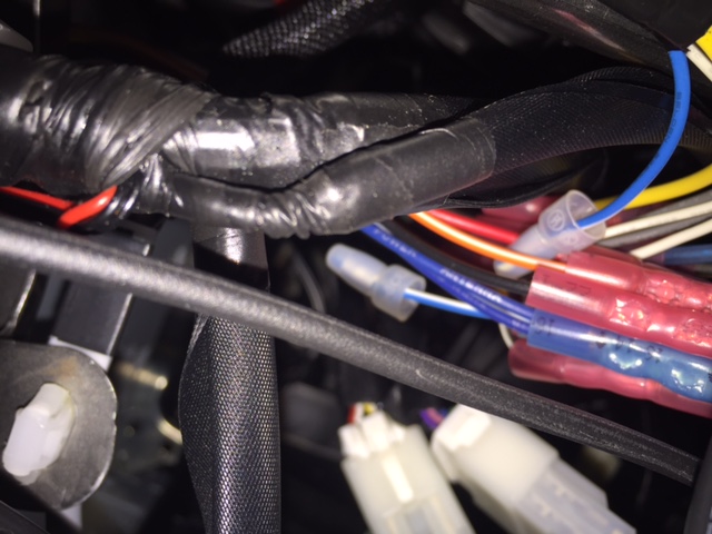

I bought the wiring harnesses that go between the factory HU and the cars wiring harness, to make my connections to. Tip: I've never removed the factory stereo, you can access the wiring through the glove box. It takes patience though.

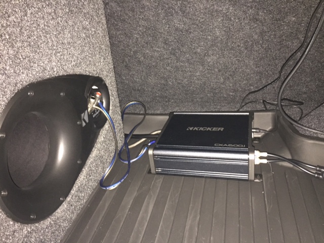

I have the 2016 Kicker VcompR loaded enclosure and the Kicker CX600.1, plenty of bass for this little car! And I'm only using about 1/3 of its potential.
Problem I'm having now is the rattling.
